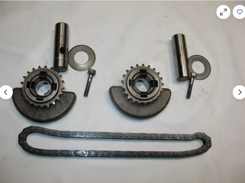

Do you know if the motor has been apart ? the 440 has counter rotating crank balancers but these have to be "timed" to the crank same as a camshaft, if assembled incorrectly they will throw the crank out of balance !!

That is excessive vibration. Something is wrong. These engines are fairly smooth, they are balanced at TDC/BDC by the crank counterweights and secondary imbalance is dealt with via the counterbalance assembly.
Bad bearings shouldn’t make it vibrate like that. Bad bearings would manifest as a knocking sound.
the countershaft balance timing is set when assembling the case halves, similar to setting timing on the cam shafts. You’ll have to get a manual to check, but if I recall correctly there is a sight window under the oil pan that when the engine is at TDC a mark will be visible. You should be able to check that the balancer is timed correctly without splitting the cases. Do you know if your friend had the bottom end open? It’s also possible the balancer chain slider wore down and it jumped a tooth or something but I’ve never heard of that happening
