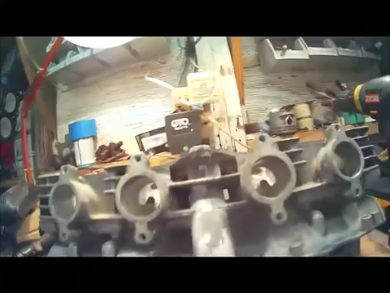

I'm still using the "Junk Head" I bought for $20. I got it for the valves, lifter cups and other things. It came without caps. I went back and found some but they wouldn't work as they were. A friend told me of a R22 head he had where he had the same problem. He honed them to make them fit. With that in mind I set out to do the same thing. One was too far out so I couldn't use it. Clay said he had a J head that was too far gone so he offered to send me one to see if it would fit. It did and I asked him if he had another so he sent me another one. As it turned out 1 and 4 were close enough to hone to size but 2 and 3 would only work if fitted backwards. The specs. are .001-.006 so with a Plasti gauge I honed them to fit. While I was at it I ported the head to clean out the casting marks and slag plus the shelves around the inside of the valve seats. Just a clean up and matched the ID's of the intake manifolds. I worked on here and there over a few months until it was done. Being the head I had on the bike needed a complete overhaul I switched them and what a difference. The bike came ALIVE.
I had a problem with the spark plug threads but that's another story. It ran so well the clutch started slipping in 2nd gear on hard takeoff. Just a little cleanup porting was a good move.
So it can be done and I figured all I had to lose was time and a $20 junk head.
I'm still using it today with my new 1075 kit installed and I'm RIDING THE PISS OUT OF IT.

09 Jul 2024 13:56Steve I've gotta say it sounds like you got lucky with that one but it's not a solution I would advise anyone else to follow (what you do with your own is your business) We have all stripped motors and found things that make us wonder how they were still running !!!
Unless you honed it on a milling table I'm not sure how you maintained the hone at 90 degree's on 2 axis ?? So although the cam to bearing clearance may be in spec I don't see how there can be even clamping force on the back of the bearing shells so it's a bit of a lottery !!!
In answer to your retorical question regarding "what did I have to lose except a $20 head" if it spins a cam bearing and seizes a cam then along with your $20 head you will lose your 1075 kit when it makes love to the valves that are stuck open
Re: Z1 head camshaft tunnel line boring specs
09 Jul 2024 14:25I had been watching it closely for a year before I installed the 1075 kit. This has been done before with success on other motors. Granted the caps must be close or it wouldn't work. My friend Jeff has a shop and has done lots of things others wouldn't even try. I wouldn't suggest buying a head without matching caps and fitting them would be a crap shoot but it can be done obviously.Steve I've gotta say it sounds like you got lucky with that one but it's not a solution I would advise anyone else to follow (what you do with your own is your business) We have all stripped motors and found things that make us wonder how they were still running !!!
BTW the wear patterns on the shell bearings are identical to the ones on my old head. I still plan on rebuilding it with larger valves or even J valves that are shorter than the KZ valves. With what I've learned I will put into the old head and keep RIDING THE PISS OUT OF IT,
