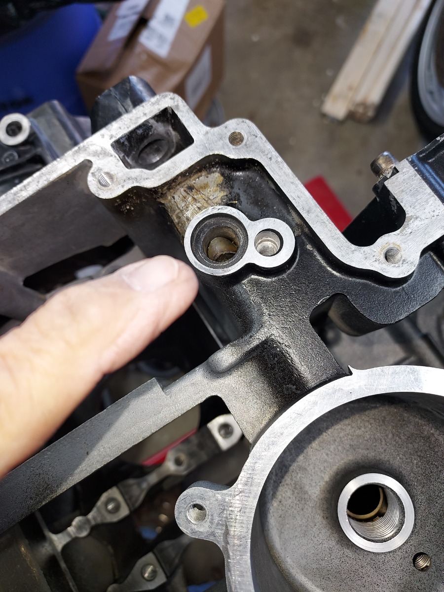

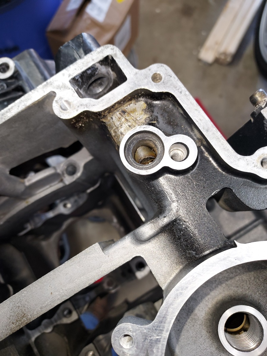

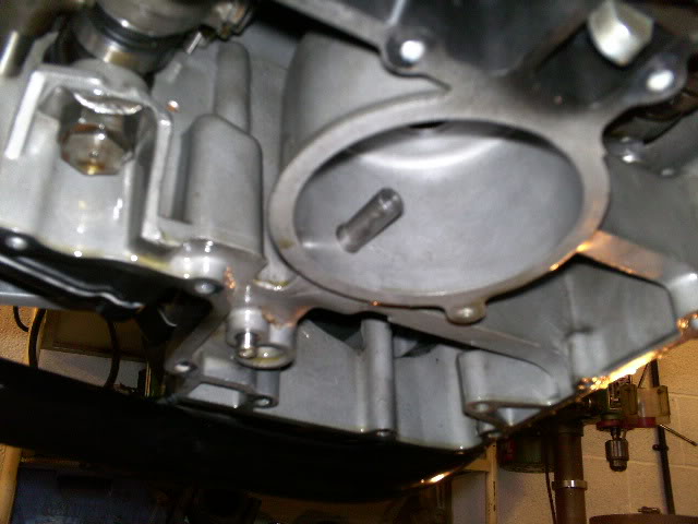

1979 KZ1000A3A MKII Present project, . Picked up from PO in pieces. Currently have the engine apart. Identified 2 issues for oil starvation:
1. Apparently he kicked up a plastic bag while riding along the freeway in So Cal. When I took the countershaft sprocket off, there was a wad of plastic behind it that had forced the seal into the engine. It was dangling there with a huge gap for oil to mist out to the chain, case, rear wheel etc.
2. Split the cases. Previous mechanic(?) installed a too-long bolt in the right lower engine mounting position. The bolt was apparently over-torqued and subsequently forced the oil -passage plug inward. The plug now covers 2/3rds of the oil access port for the Pump to Filter pathway. Trying to come up with a workable solution (maybe drill out the plug then install a threaded plug? - May have to enlarge the engine mounting hole for access, then install a bushing to return to correct size).

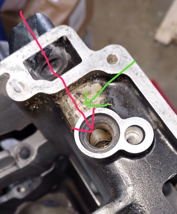

Just a thought on the oil way plug issue, could you do the following
- Drill and tap the plug blind at 6mm or 8mm (pink arrow)
- Screw in a piece of all thread
- Run a nut down the thread to a large washer against the outside of the casing, thenwind the nut downto pull the plug back into place
- Drill through the casing (green arrow) and "pin" the plug to keep it in place (sink the pin below the surface of the casing and peen over to ensure it stays put

There's enough room in the oil filter chamber to insert a steel rod and either knock the gallery plug back into position or drift it out through the engine bolt hole and replace with a tighter fitting one if it leaks.
Been there , done that..

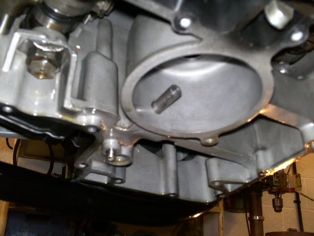

Thast interesting. I ran into the same issue with a KZ900 engine i'm working on where they used a longer bolt and pushed the 12mm plug into the 10mm bore. But in my case the case popped open. So it was leaking back into the sump and also out the side and all over. All the pieces were still there but bulged out and cracked. I removed the pieces and smoothed the edges a bit. I was thinking of welding it up and machining for a new plug but the cost would be a bit. I thought about it and decided to make two plugs, the first would seal the oil supply port and the other would seal the outer case. I figured there was enough wall thickness to seal so the plugs were a tight fit and I also used some red locktite which should keep them in place. The plug that seals the outer portion was set a bit deeper and filled with JB weld also. I was thinking of tack welding those two plugs but I think I will leave them as they are. I plugged the oil pump supply cavity with thin oil and had no leaking past that plug. I will also leave the case like it is rather than attempt to weld around those plugs.

Much thanks for the suggestion. I was planning to take the case to my friends shop Saturday and drilling out the plug, replacing with threaded plug. Like your suggestion. Will try that first. Thanks again!

03 Apr 2024 14:12As already mentioned above.Much thanks for the suggestion. I was planning to take the case to my friends shop Saturday and drilling out the plug, replacing with threaded plug. Like your suggestion. Will try that first. Thanks again!
The plug will easily knock out through the engine mounting bolt hole using a drift inserted from inside the filter housing.
I have done many and simply replaced loose ones with a tighter fitting bung machined on the lathe.
