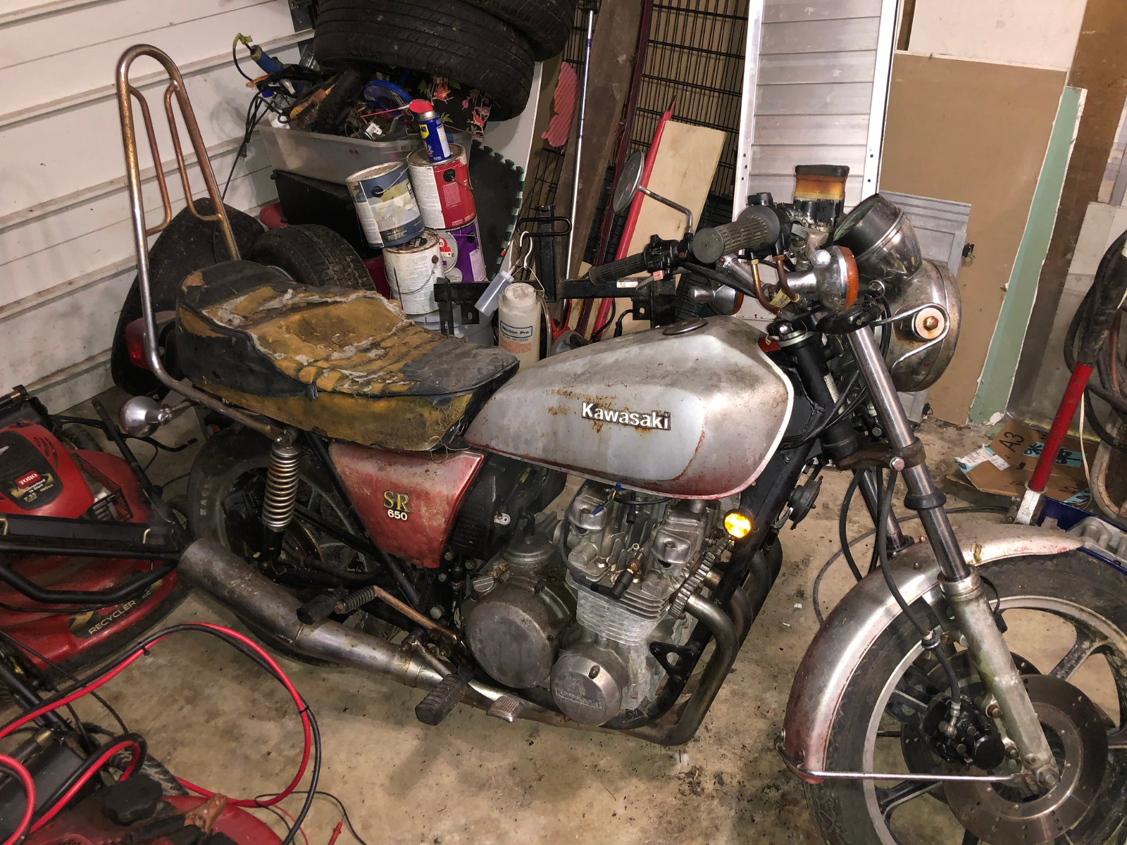

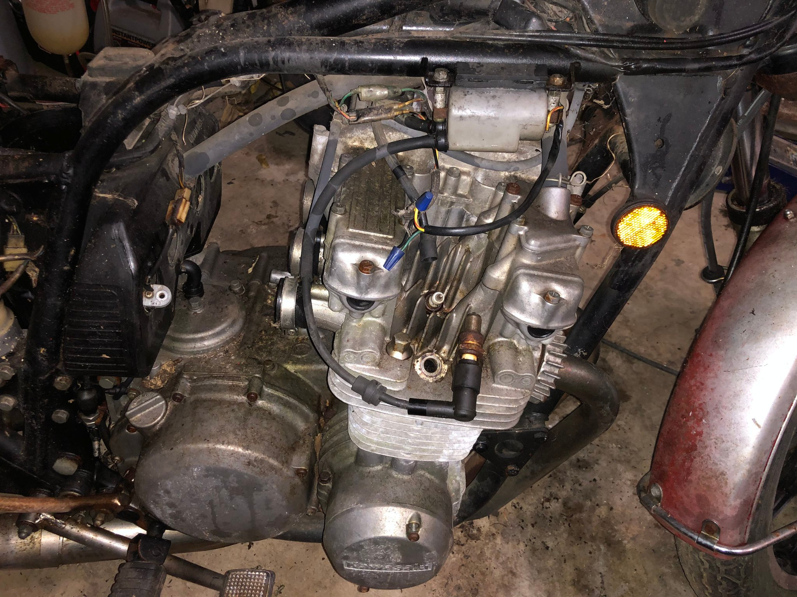

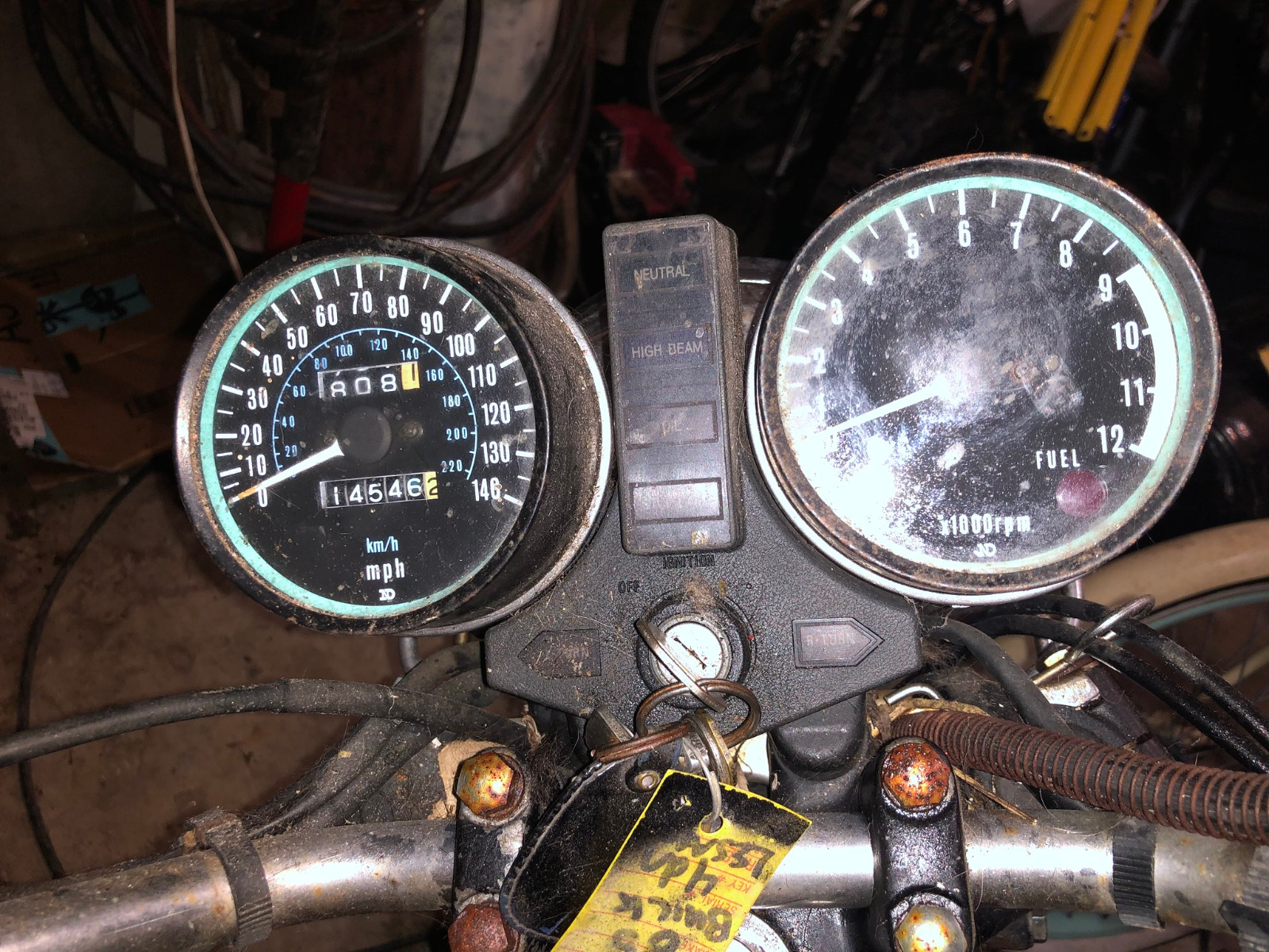

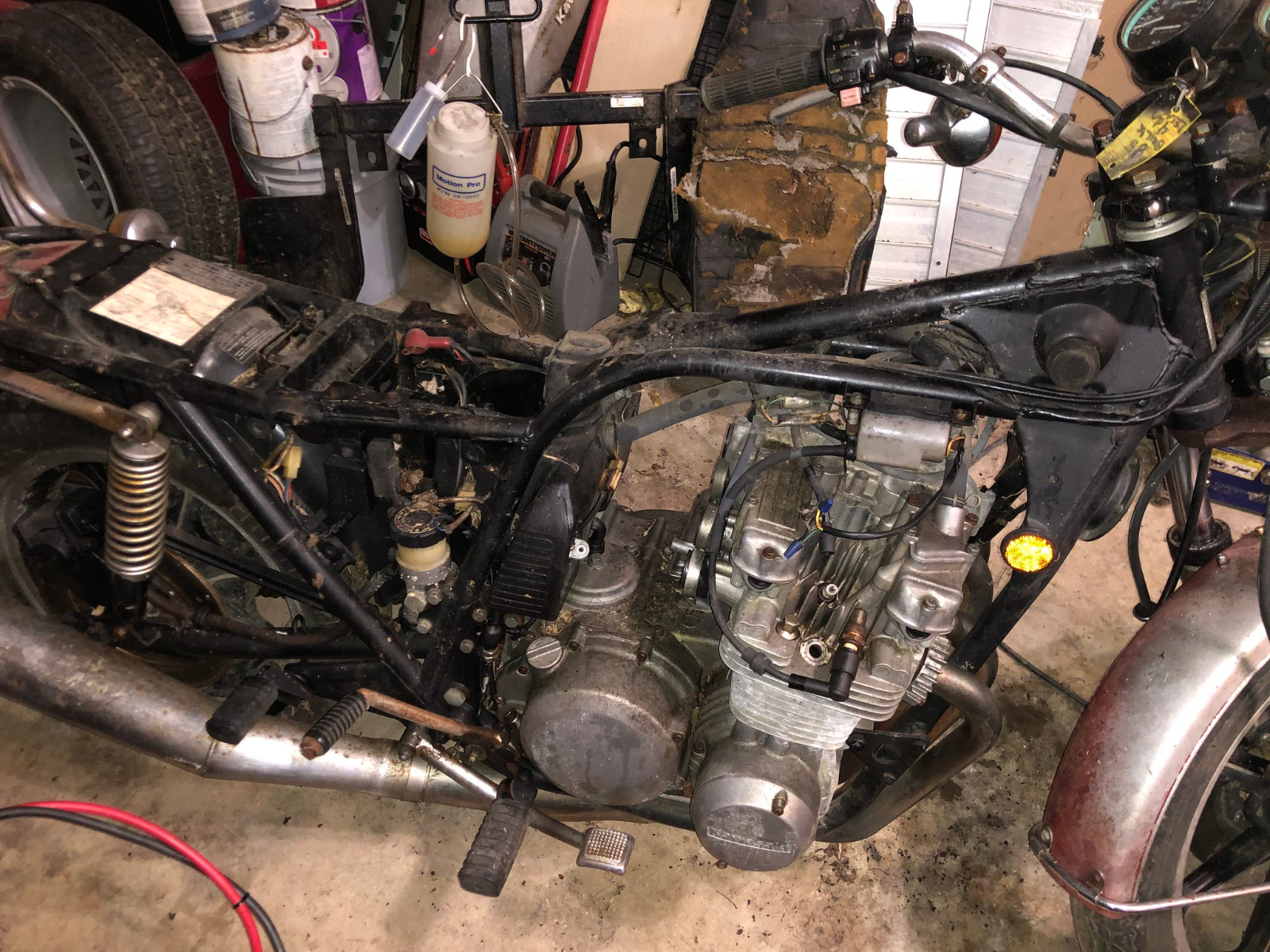

Okay guys I’ll swap the oil before starting, though was only going to run it maybe 10 seconds and then proceed with that (if I can even get it to run), how I do lawn mowers and other small engines, perhaps I have developed bad habits. Of course I always check the oil level and see what it looks like first.
The electric starter motor does nothing when I hit the button. Not sure if the brakes need depressed or not, I believe I tried holding the clutch down as well. The front brake master cylinder is seized, so can’t squeeze that one at the moment. Not sure if my dad ever told me what the issue was with the electric start, but I do recall him saying something about it. I have not even looked at that yet since it has the kick starter, looked like a pain to get to the starter motor, but suppose I could check some voltages / the switch.
I thought about posting photos, but then I also thought maybe it was a bad idea being the poor condition it is in from neglect. The seat is trashed, the seat pan is pretty rotted, but I “may” be able to weld in some patches if it isn't too bad, but my main goal is to see it running, like I said the front brake master cylinder is locked up, tires do not hold air, the rear tube valve stem is gone as well, so little stuff like that I can work on after it is running. It will most definitely take quite a bit of work to get it on the road, if I do manage to get the engine to fire up.
Suppose I'll post some, even thought about doing some videos of the project. Here is a recent one I took the other day and some misc others. My dad did paint this in the early 90’s, but I think he used whatever paint he had on hand at the time which was a lacquer I believe (he painted cars so had a ton of old left over paint from years prior), but it was very similar to the red that was OEM on these
Oh and the date on the head tube sticker shows 9/78, don't think I mentioned that in original post.

Was surprised 3 of the lights worked, 4 actually, but one signal is missing the reflector that allows it to ground the bulb.
Attachment not found

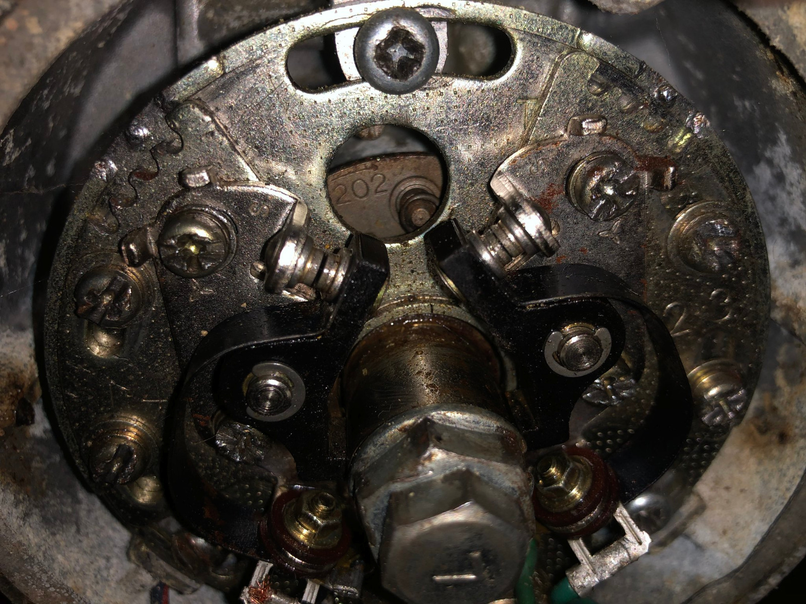

Points were somewhat dirty, but they seem to be working at the moment after a quick cleanup. I do see spark at all four plugs now, at least for the moment.

Points were a little crusty, but cleaned up okay and seem to have spark at all four plugs afterwards. Could likely use a bit better cleaning, but haven't had a lot of time to fool around with this yet.

Those points look rough, and you can see that somebody has been in there with a Phillips screwdriver and buggered all the screw heads up. I would soak them for a few days in a good penetrant (NOT WD40). Then I would try them with a proper JIS screwdriver or a suitably modified Phillips. If they are really stuck, a small impact driver may be needed.
Are you sure that kick start lever works? It should spring back to vertical of its own accord. Also, it looks like it will hit the brake lever, but that may just be the angle of the picture.

TexasKZ wrote: Those points look rough, and you can see that somebody has been in there with a Phillips screwdriver and buggered all the screw heads up. I would soak them for a few days in a good penetrant (NOT WD40). Then I would try them with a proper JIS screwdriver or a suitably modified Phillips. If they are really stuck, a small impact driver may be needed.
The kick start lever will spring back up if I kick it and let go, like everything else, it probably needs attention too, but enough to crank the engine. It does not hit the brake lever, it goes all the way down vertical to the foot peg bracket, if it rubs it would be at the foot peg (I just went out and double checked to make sure). Seems to crank well enough to be able to start the engine.
Yeah I Seen the point’s screws all chewed up so knew it has been fiddled with. I've been hesitant to take them out yet :unsure: . I mean they move now and makes spark after the quick cleaning, perhaps soaking it would be better. I'll see about making a Philips fit them when I get a chance. I’ve got a ton of random Philips screwdrivers / bits, so should have something to shape to fit good. I do have an impact driver as well (the hand style you hit with a hammer).

KZNinja wrote: ................ I’ve got a ton of random Philips screwdrivers / bits, so should have something to shape to fit good. ................
As TexasKZ mentioned there are NO Philips screws on the Kawasaki, so using a Phillips screwdriver on them may (or may not) allow you to turn the screw but it also will damage the screw. Those screws that look like Phillips are JIS (Japanese Industrial Standard). Notice that the screws on the points plate are damaged. That's because a Phillips screwdriver was used. It will not properly fit the JIS screws and damage will be the result. The good news is that you can easily make JIS screwdriver bits from Phillips screwdrivers. Ed
Yeah I didn’t word that correctly, I meant that if I don't have JIS I have plenty of spare Philips to file / grind one to shape when I said “shape to fit good”. I may even have JIS type if I sift through some stuff.
