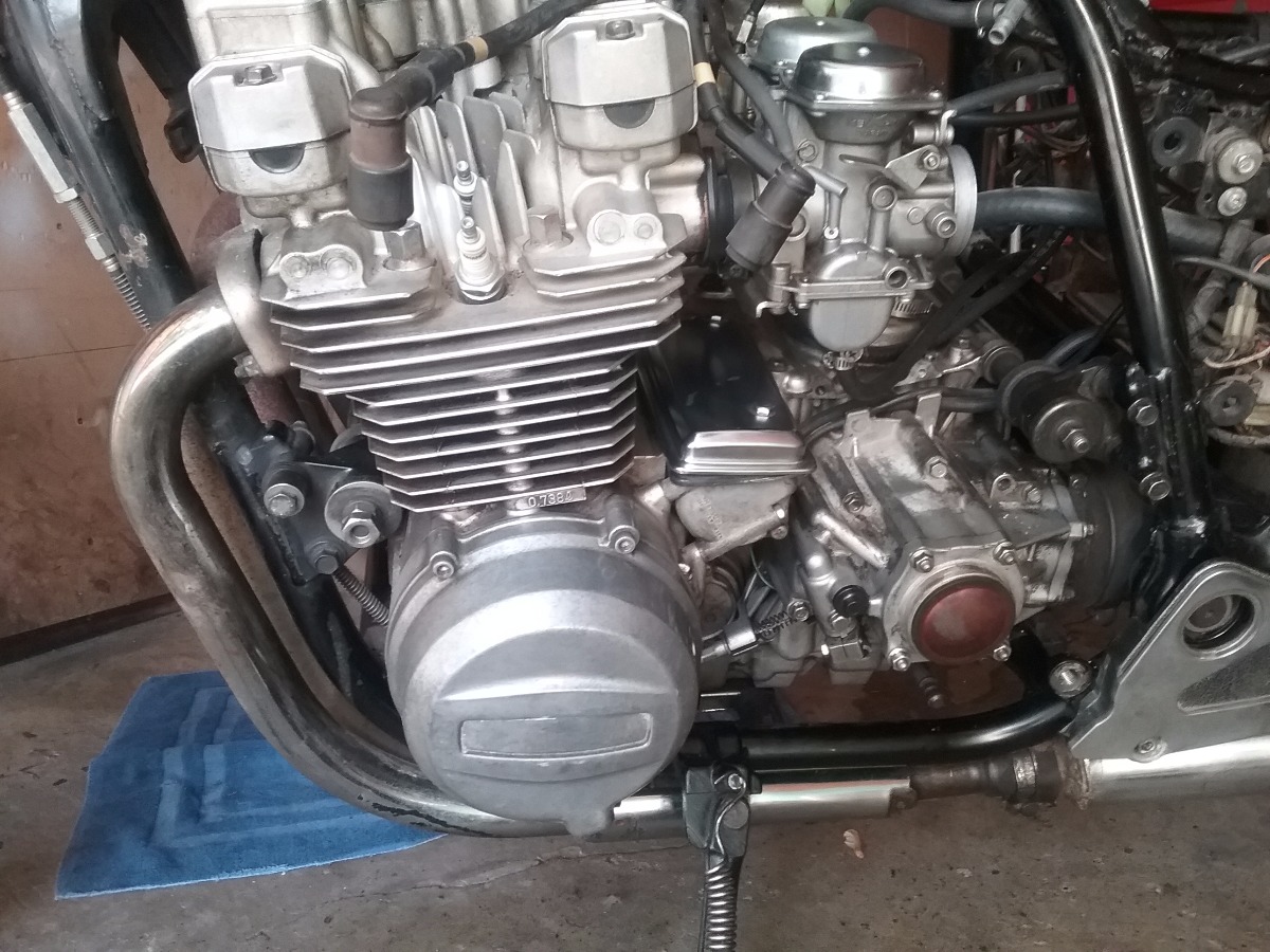

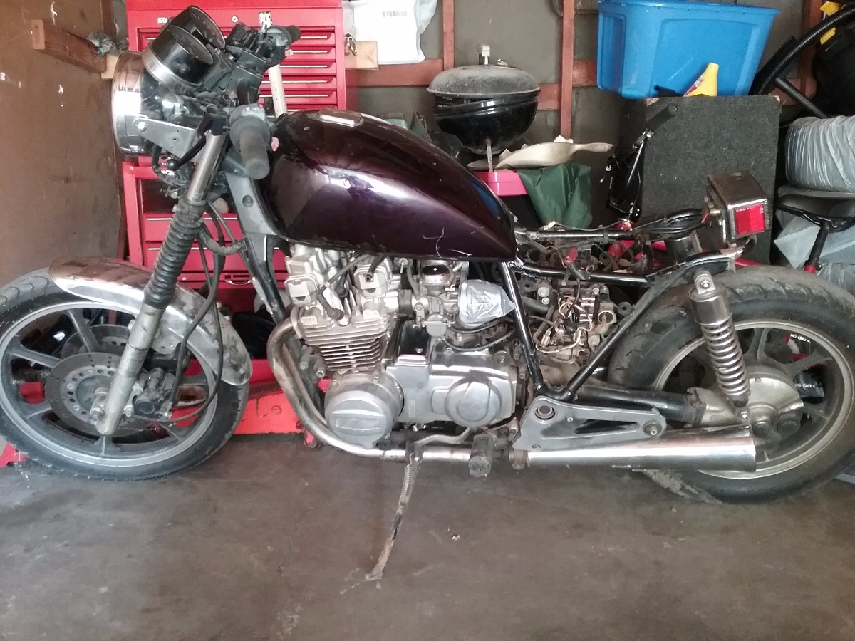

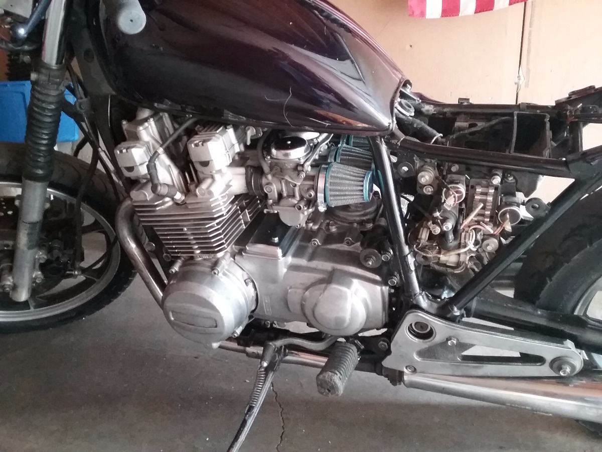

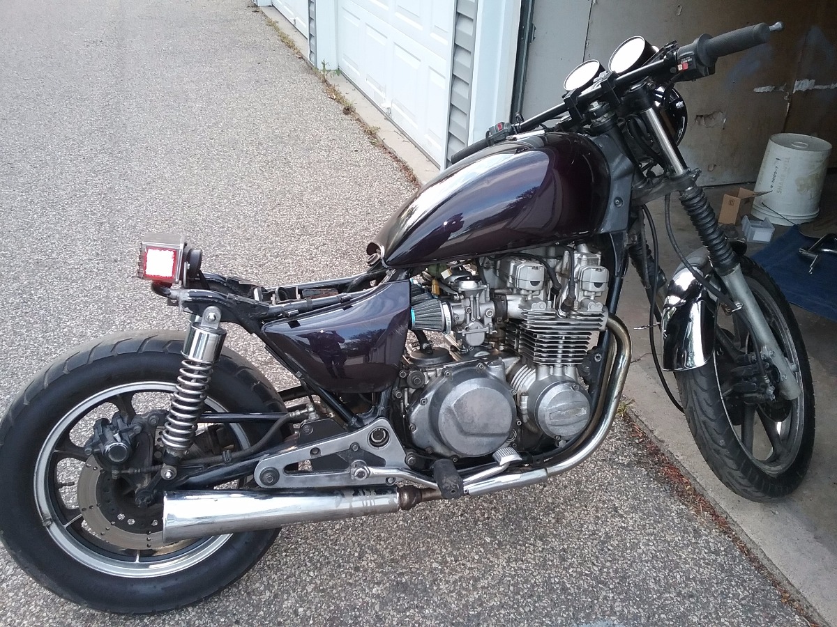

I've been lurking on here for a couple weeks, and I was kinda impressed with the layout and information on the kz's. So I decided to join up. Thank you mods for keeping this site rolling.
Anyhow, my name is Josh I just got an 83 kz750 ltd shaft (f1) for 200 with a clean title. P.O. got it from a guy who was going to Bob it. Said it needed a gasket due to oil leaking. He said it was the lower case. Well, I found leaks at the shifter shaft seal and the secondary shaft seal. Also said it cranks but doesn't have spark. I found an ignitor in the bucket of parts, hooked it up. It needed a battery, so I bought one. 33 bucks on sale. Fixed some wiring, charged the battery and, low and behold, spark. Ok. It needed a seat, found one last night, ordered it up.
Now I tried to fire it up but it was a no go. So as of now I'm waiting for a pilot jet that I found was stripped in the carb. Keihin of course. Found one tonight, ordered it up. Atleast I only had to drill the one out, somehow thankfully I didn't mess up the threads. I took the other ones out just to make sure they wouldn't strip. They are good to go ( after I clean the green crud from them)
And that brings us to this moment. Where I decided to join this wonderful site. I bought the bike as a project of course, and I was weary at first but with the forum here, and search functions I've learned quite a bit about these bikes. So thank you.
Adding a couple pics out of the 50 or so I have so far.
