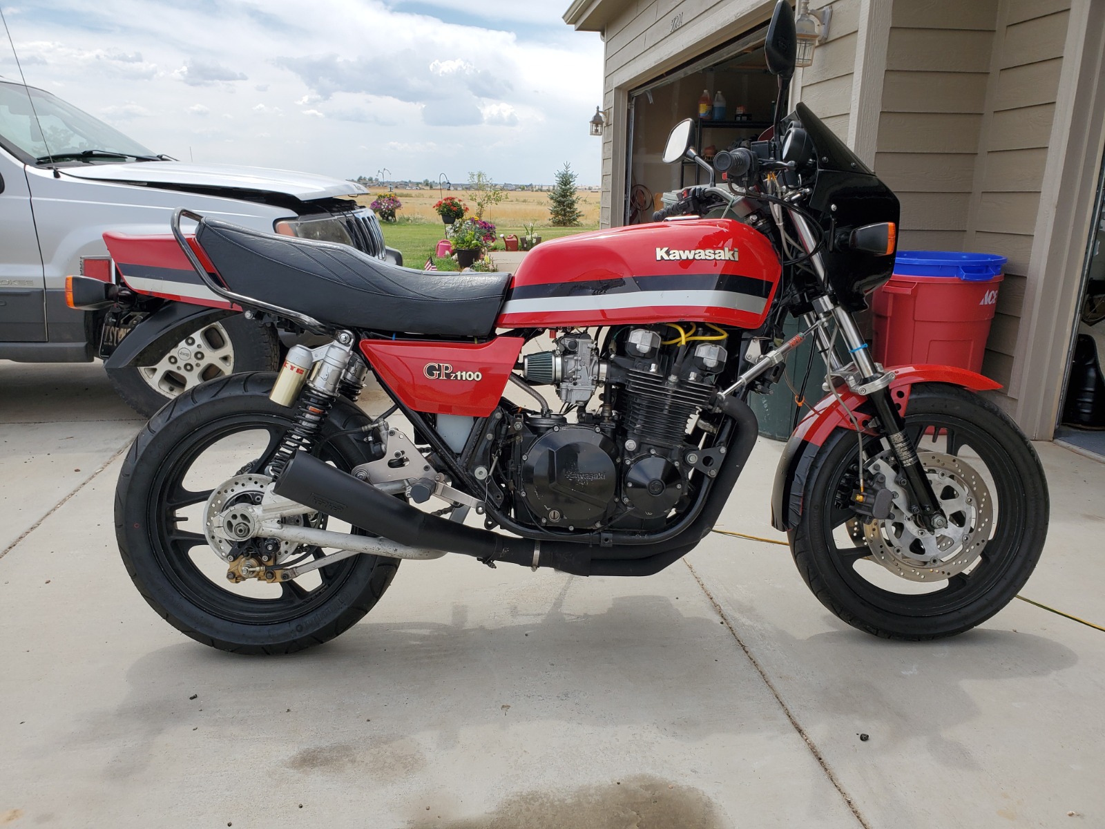

Replied by 577nitro on topic 1981 gpz1100 project resto-mod
03 Oct 2020 15:27
Ride report and update..
So I now have a full summer of riding on the GPZ1100 with suspension upgrades...wow what a difference! I LOVE riding this bike! I used it to commute to
work about 70% of time this summer, and have put at least 5000 miles on it. I ride 600 miles a week commuting, about 60 miles one way on back country roads.
Needless to say I really let're eat on some sections....rock ass solid at 100+ no problems. No slappers, wobbles, pogoing...nothing just stable as can be. Power is wonderful now that I have the Mikuni RS34's dialed in as well. It will pull redline in every gear...roll on is massive no need to downshift. It easily is making the same power as my ZRX1100.
Here is what my current suspension mods are sitting at:
1. ZRX1100 rear swingarm with 20mm through bolt (zrx1100 rear axle) upgrade, hole reamed slightly tight for zero slop per Dr. Gamma advice.
2. 1986 GSXR1100 front and rear wheels, for a 4.0 inch rear with a 150 mounted and a 2.75 front with a 110 mounted.
3. Critical step here..front and rear wheels perfectly aligned < than a 1mm off. They were at least 1 cm off when I first checked it! This is key to fixing slappers.
4. NHK high end steering dampener.
5. S1 style lower triple clamp from Motogp. Stiffened the forks.
6. ZRX1100 rear shocks overhauled by DMR Jamie Daughtery << great guy.
7. Installed RaceTek Cartridge emulators both forks with O rings for a tight fit..1.5 clicks in. per side.
8. RaceTek fork springs.
9. Critical point here, multiple weeks testing the perfect fork oil mixture for this setup. For me 20ml ATF with seal conditioner, 30ml 75-120w synthetic gear oil (for rebound), then the remaining 10-30w synthetic motor oil. Also 10psi air per fork. For more rebound add the gear oil in 10ml increments. Caution this only works in ancient NON cartridge forks. I use this same basic formula in my RZ350 also...works perfect.
10. Change the fork oil often, dirt and grit contaminate it causing leaking seals. I found a way to change the GPZ1100 fork oil in about 15 minutes. I use a an old Hyperlube bottle which as a cone sprout. It fits perfectly into the air valve hole (remove the valve) and I have pre measured the oil and just let drain in. cap it and use a bicycle hand pump to put 10psi in per side. ..and Bobs your uncle.
11.Lasty, a Fork Brace.
Before modifying the forks like above, they were worthless...bottomed on braking, zero dampening down right dangerous. Now, they work like modern forks, fork travel is around 3.5 to 4 inches max..no bottoming, no diving on hard braking, and great rebound dampening. They are far less harsh than my ZRX, that just beats me to death. I can go over a real bumpy patched road surface at speed 90+ and it just floats over it...never gets upset. I tried Dr. Gamma's trick of slapping the bars ar speed to try and induce wobbles and nothing...I did this at about 65mph...not 90 like he does..not that brave..

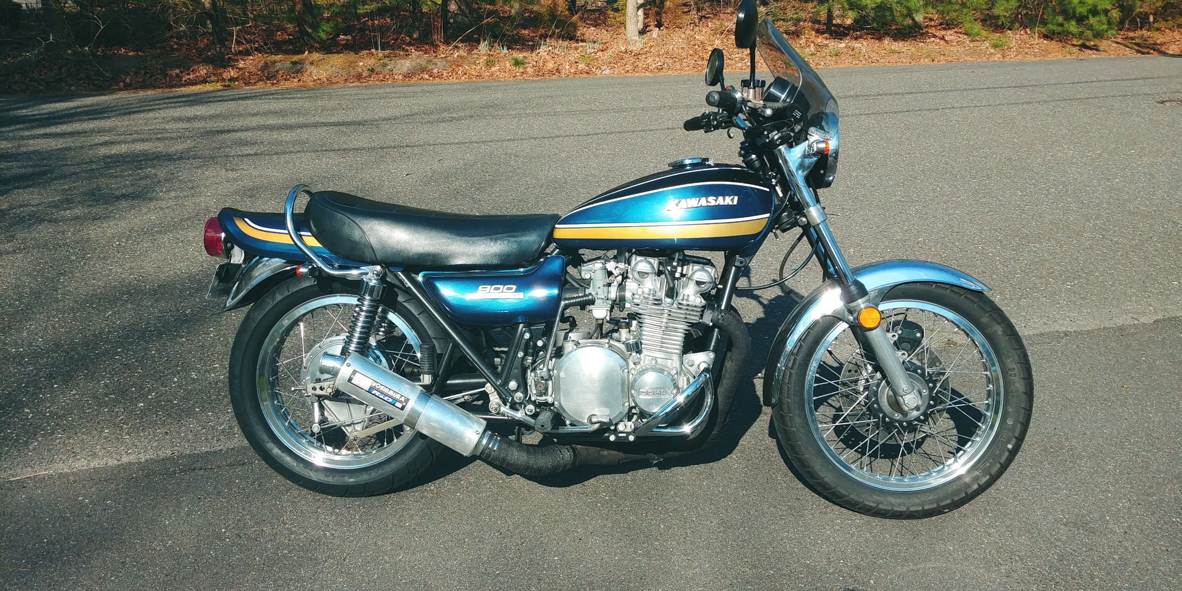

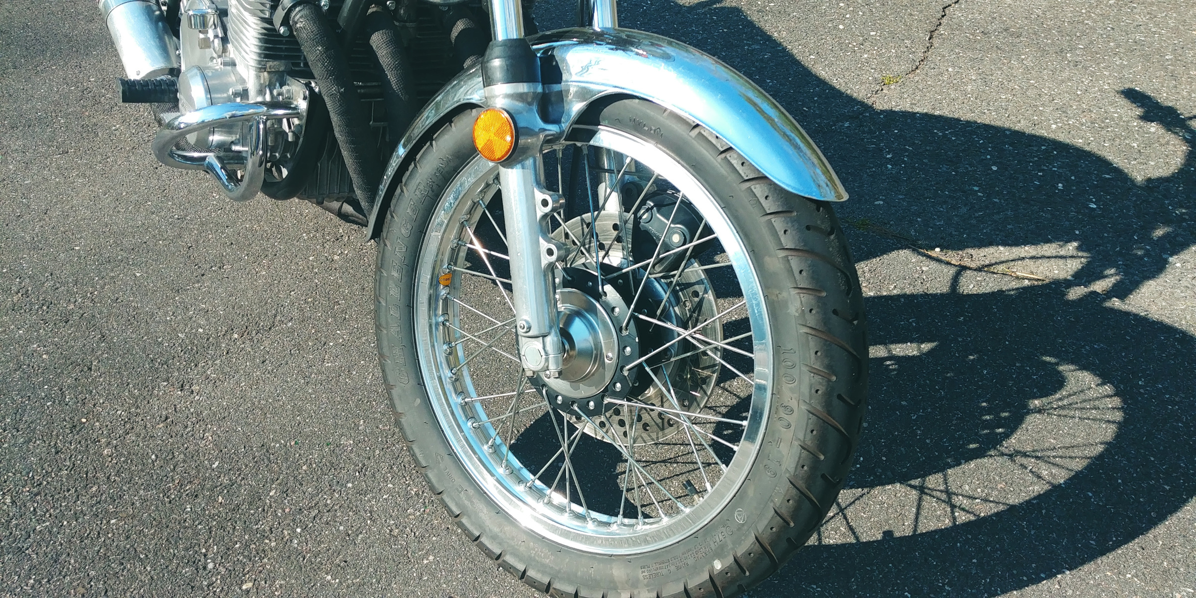

Replied by Kidkawie on topic 75 Z1 Resto
11 Apr 2020 14:03
Bringing this thread back from the dead since I made a bunch of changes.
First off, swapped out the Euro bend handlebars for the Emgo 23-12565. I never liked how the Euro bars bent down like clip-ons. With a MX background the new bars are wide, and flat. Just how I like them.
Also swapped out the directionals for some real nice polished cast aluminum ones, I think another Emgo product. Highly recommended, but to mount to the headlight is a bitch.
New Racetech fork springs. I was going to lower the ZRX shocks to 11.5" but decided to just buy a set at that length to see if I liked it or not. To mod the KYBs that much there would be no return. So we'll see how it goes, so far so good.
Last I swapped out the rims for Akront (repop) with a wider rear rim and tire. Went with a 3" rim and a 140 tire. Would liked to have gone 150 but Id rather play it safe on this one.
Last is the exhaust. I made a thread on it but basically remived the left side Hooker and fabbed up another system from parts. Sounds great, runs great.
Also snapped the hi/lo headlight switch......again. lol
