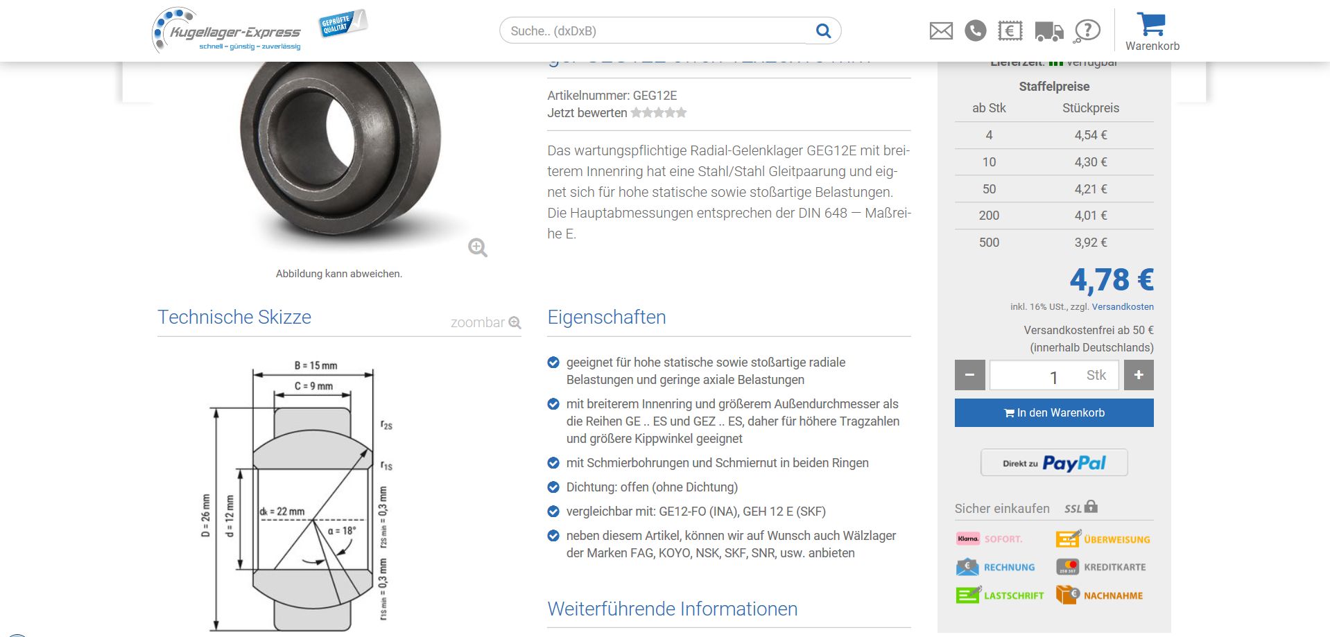

on my Z750 A (GPz 750 ut) one for the two joint balls connecting the rear swing arm to the mono shock is worn and seized and needs replacements.
Unfortunately NOS is not available anymore.
Does anyone know by chance if there is any substitue around or if there is a different NOS # from any other Kawa models that may fit,too ?
Original NOS # for my model is 59266-1008.
Thoughts highly welcome
Thx in advance
Cheers
Jorg

No eBay APP ID and/or Cert ID defined in Kunena configurationDo you have any dimensions ID/OD of the ball Joint?
www.kugellager-express.de/wartungspflich...2e-offen-12x26x15-mm

Hi Scirocco,
thx for reply !!! The one on ebay is the one I need. I ordered it right away. Apparrently 1008 and 1051 are idential from the dimensions.
you made my day
Cheers Jorg
