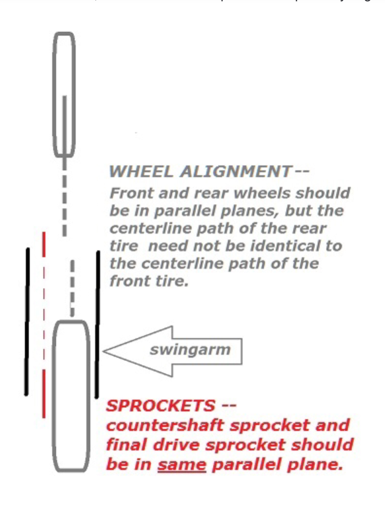

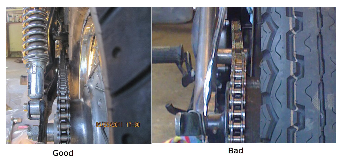

Wanted to mention the below screen shots were lifted from a post by Patton, all credit to him for this information. I’m just posting to help the OP
Here’s what your shooting for. The right to left location of the rear wheel is set by the axle collars, those are factory design. Should be able to align as long as OEM collars/spacers are in the correct place.
