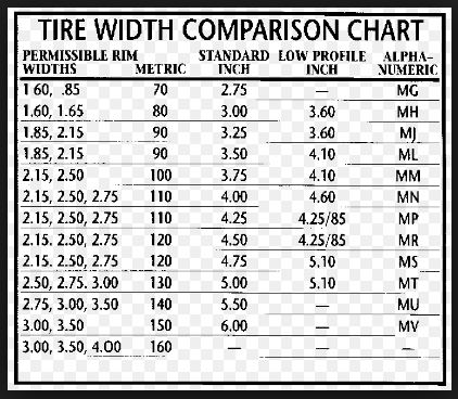

22 Feb 2019 13:44650ed wrote: 110/90-18 is too narrow for the rear of a KZ650.
For many years I ran 130/90-18 on the rear of mine, but eventually I learned it did not offer any advantage over the 120/90-18 tire. The 130 was difficult to mount and I could not use the stock chain guard without the tire rubbing. Also, squeezing that tire onto the stock rim deformed the shape of the tire so It did not have any larger contact path than the 120/90-18 tire. I switched to 120/90-18 and will never use the 130 size again. Also, I use tubes and rim locks. Ed
Ed, just wondering why do think 110's are too narrow? The stock rear tires were 4" wide. 110's are 110 mm wide, which is over 4.25". I have run 4" x 18 , 120 , and right now 110 . They all fit and handled fine to me.

I guess a 110 will work, but given the 2.15 width of the stock KZ650 rear rim the 120 is also a correct fit (see image below). Either size may be appropriate, but I prefer the wider of the two. Ed
