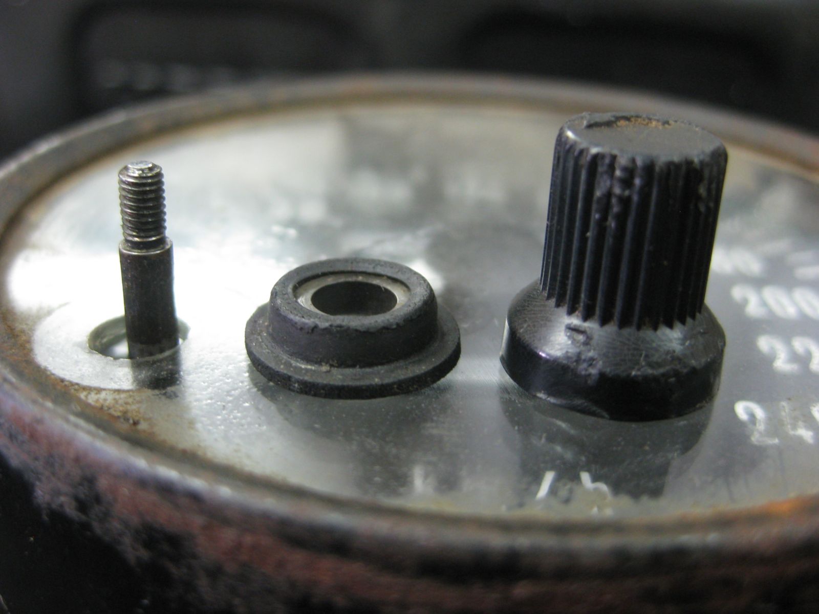

What is the speedo off?
Z1-R speedo has a reset knob out the front it has a LH thread and the reset shaft doesn't rotate CCW,
which allows removal of the knob - see pic.

'83 1100 spectre. The guages are a one piece unit. The trip knob disappears inside the unit and there is no shaft to grab. I tried again tonight but no good, so I had to put it back together as is. It turns freely the other way so I can't unscrew it in any way.

Can you please post a close-up pic of the knob - sounds like it might be a push fit if there's no screw holding it on. If it "free-wheels in the other direction then it's probbably not a LH thread screw-on shaft.

I have sane bike. Just took mine apart to install new tach. I used a micro Philips screw driver. I don't remember mine being reverse thread though. Screw is super small. I left mine in knob do I didn't lose it. Drop that sucker game over

21 Aug 2015 22:42that is the way the knob mounts to the shaft on some of them but the shaft is a reverse thread on a collar76KZ900 wrote: I have sane bike. Just took mine apart to install new tach. I used a micro Philips screw driver. I don't remember mine being reverse thread though. Screw is super small. I left mine in knob do I didn't lose it. Drop that sucker game over
