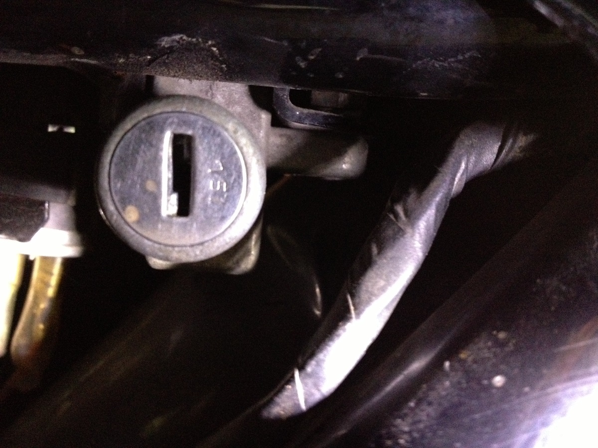

Hi I had a problem today when my ignition key wouldn't work and I ended up snapping the key at the petrol station and I had to push the bike home about a mile. I had another switch which I fitted and was able to get the bike started and was able to go for a ride. Now the problem is I cant unlock the seat , I have tried a couple of keys but no joy. I tried removing the pins that fit through the hinges on the other side but only one will come out. I a m thinking the only answer is to drill the old one out any else have any ideas.

Thanks everyone, I have found a number on the ignition lock 361518 but I am not sure if that is a code as all the codes on the ebay ad had a z in front and the new keys have a z on them. I will get my magnifying glass out and see if theres any code on the seat lock

Hi, therres no key code on the key, its a replacement key. I hope to take the lock to a key maker tonight . If that doesnt help ill try and get the dowels out of the lock to get at the barrell.

The Z key code number is on the seat lock, but you need to take it out first as it is out of sight. It is stamped behind the lock body, .This 4 digit code will get you a new key cut, there is a guy on ebay who does it.

Hi managed to get the barrell out of the lock by drilling out the dowel pinms, found the z number after scraping the paint off, further dismantled the lock and recovered the broken piece. Will be going to the keycutters tonight. Martin that is a very informative picture nice that its on record to help out anyone else in future.
