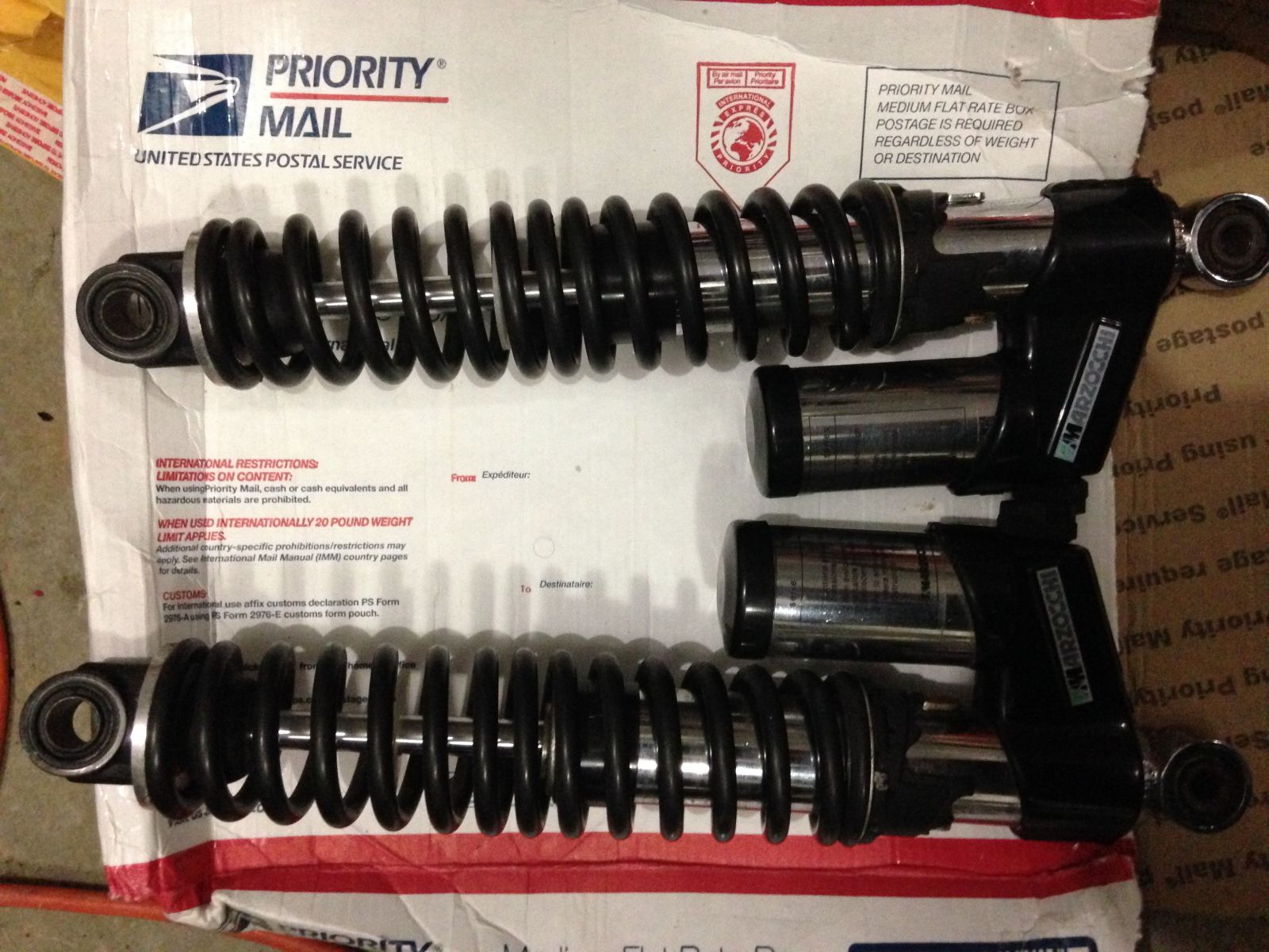

- Arial Bender
- Posts: 21
- Thanks: 3
- Arial Bender
- Posts: 21
- Thanks: 3
Re: Marzocchi strada oil
10 Jan 2015 20:49
Bottom right corner, from last rebuild kit.

- spdygon
- Posts: 1013
- Thanks: 117
10 Jan 2015 21:20
Awesome.....
Thx for the copy I have save it. So it's SAE 5
