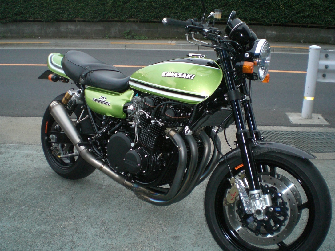

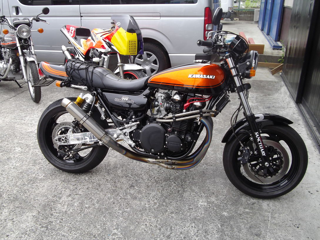

the sanctuary guys utilize a custom bracket and the top shock mount bolt to attach the exhaust.
or weld a couple bungs on and make a custom bracket to attach to them.
hth,
