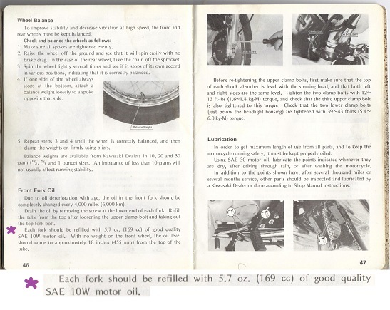

23 Jun 2011 15:40
While I prefer using a dedicated "fork" oil of whatever weight desired, and have also experimented using ATF,
The original 1973 Z1 OWNER'S MANUAL does indeed specify SAE 10W motor oil.
FSM for "73 Z1 ~ '76 KZ900 (Revised 6:Mar. 28,1977):
@ page 113: SAE 10W non-detergent
@ page 175: SAE 10W non-detergent
FSM for "77~79 KZ1000 (Revised 4:Mar. 12, 1979):
@ page 127: SAE 10W fork oil
@ page 183: SAE 10W
@ page 250: SAE 10W20
@ page 256: SAE 10W20
Am guessing the dedicated fork oil or ATF might enhance life of rubber seals.
Might be wrong, but think that "foaming" isn't an issue with motor oil, fork oil or ATF.
I do know the '73 Z1's original factory installed "fish oil" was nasty stuff.:pinch:
