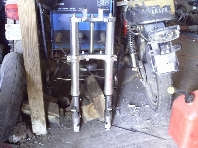

roynor's j model project has a busa frontend on it.i converted the lower tree over to a kawi stem for him.
putting a busa frontend on is pretty much the same as any sport bike frontend swap.you have to convert the stem then it bolts on,and you have to figure out if you are going to use clip on bars or mod the upper triple clamp for bar clamps.i have a frontend i have put together with irishwills billet upper triple and a gsxr 1000 (stocker from irishwill)lower triple clamp and busa legs.i am going to use one of irishwills billet stems that fits the gsxr on bottom and the kz on top.i still need another older style(non mono block brakes)leg for a busa as one of mine has a bent chrome tube.
