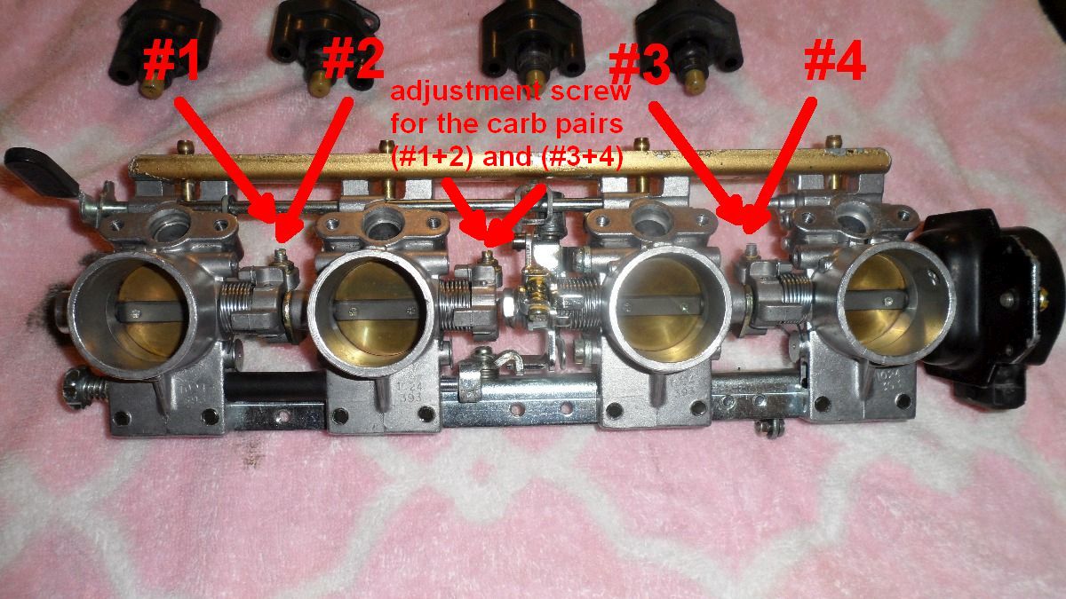

How do I syn the throttle bodies,is there a special Vacuum tool ??? If so could you link me the site. As well as the TPS Sensor.

You need a carb sync tool. My carb sync clocks looking like this
and are not the cheap Chinese crap you can buy for money.
I bought them 25 years ago for 150 German Mark = 75 Euro
and now they were sale for up to 250 Euro
A quick guide to sync the carbs:
first sync #3 with #4, (#3 is the master, all other are the slaves)
then sync #1 with #2 ( independent with #3 and #4)
then sync the pairs (#1 + 2) with (#3 + 4)
do little 1/10 turns only, every little turn interact with the other carb vacuum.
repeat the steps until you get the minimum difference on all carbs.
Have fun
Michael
Have fun
Michael
