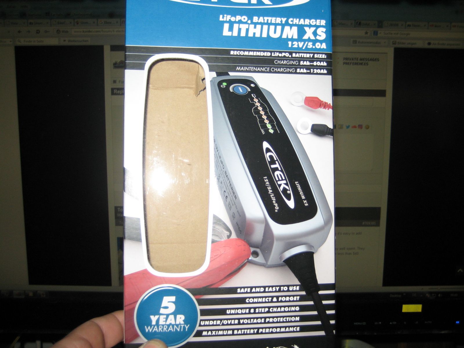

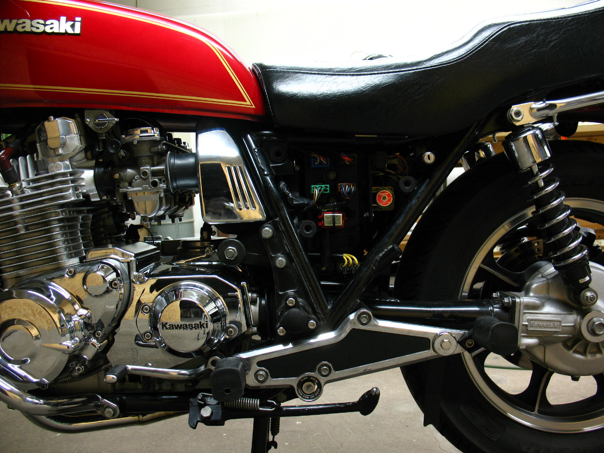

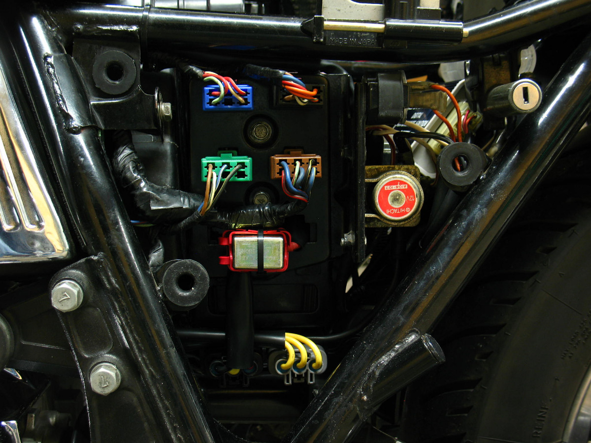

21 Aug 2017 15:58 - 21 Aug 2017 16:10
I have no problems with my charging system.
I have extra terminals on my LI battery
The best advantage is you can mounting the battery in any position you need, like upside down.
And for the winter time and worst case scenario a CTEC charger.
Charging the LiFe battery in 45 minutes to full capacity and not in 6 hours!!!
