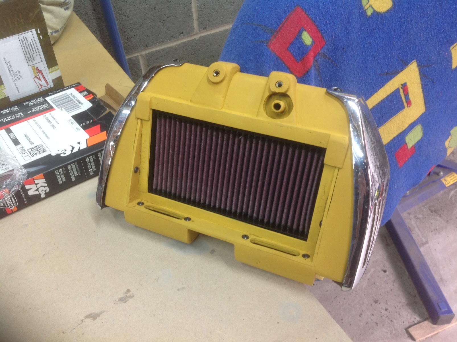

- Posts: 6893
- Thanks: 4335
Re: Drill vacuum throttle gpz750?
08 May 2023 07:00You could do something like thisThat does not sound like a sealed air box, could you post a picture?Thank you for the advices.
Instead of experimenting with the hole diameter I did the easy solution and covered the filter with thin fabric to increase the vacuum.
now the bike runs great but a bit rich on top so I have to rejet.
I use the front part of a GPZ air box with the rubber runners and then a square foam filter over that.
08 May 2023 11:07
Not quite what Kawasaki Engineers signed off on.

- Posts: 6893
- Thanks: 4335
08 May 2023 15:46Do you mean like putting an 1197 motor in a 650 chassis the stock unit wouldn't fit with the mono shock and to be fair it was so restrictive it's ridiculous. I have never seen a stock air box on anything with so much baffling (I quite like induction roar)Not quite what Kawasaki Engineers signed off on.
