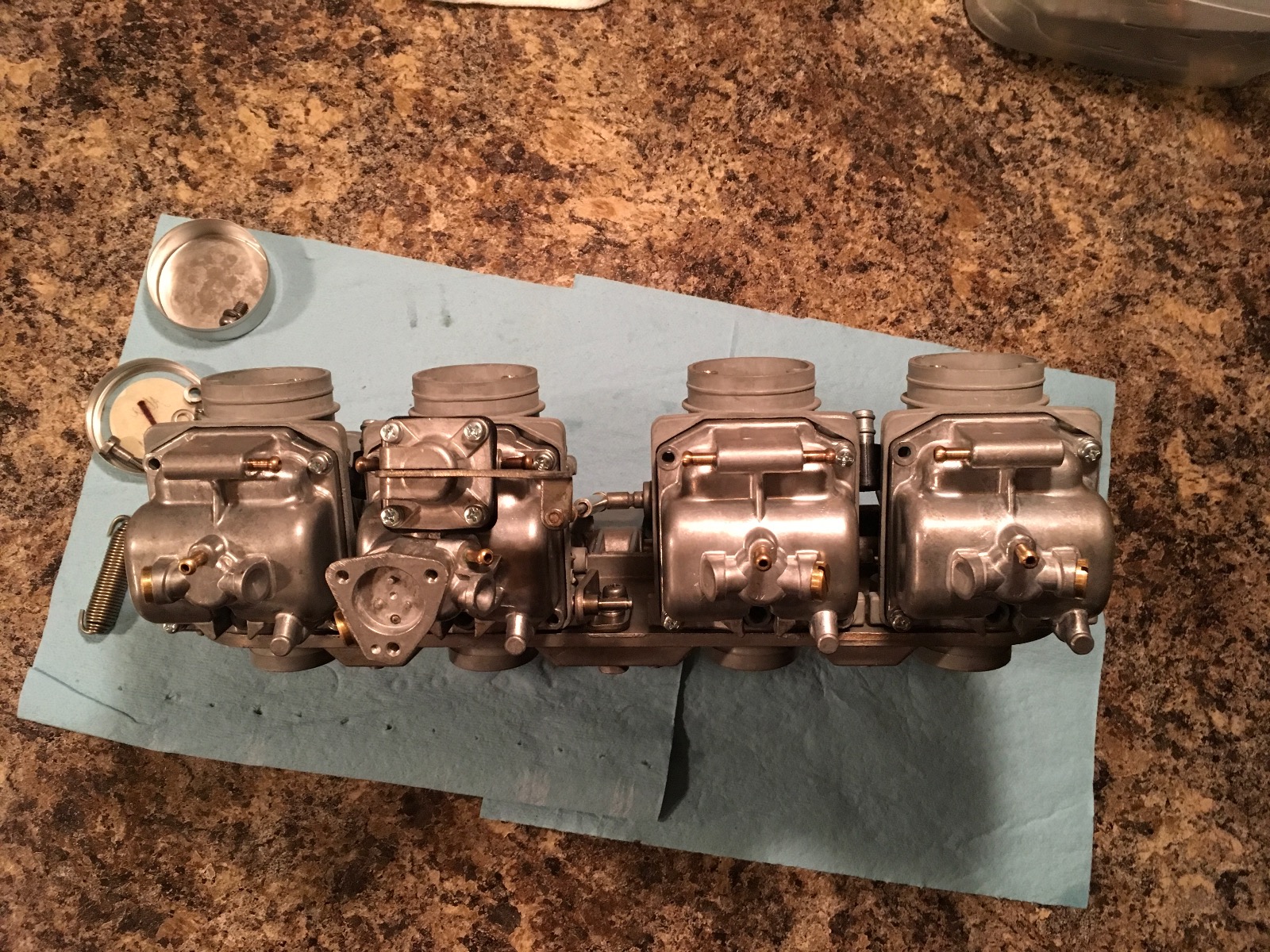

These are the correct carbs for a 1980 KZ1000 B4
I bought them used and installing them on my 1978 KZ1000 B1
I’m just finishing up a rebuild on them with the help of members here specifically Zed1015.
I bought Keyster kits but only because the used carbs didnt have any main or pilot jets. It was the cheapest way for me to go. I was pleases to find out the Keyster kits have a rubber bowl gasket that seam very robust and should be a big asset when tuning. . I’m learning also that others here are correct to not buy “kits” to many variables and wrong parts.
The following user(s) said Thank You: Rich K.
