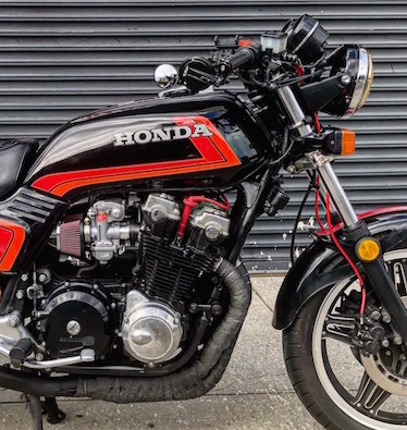

23 Dec 2018 18:19baldy110 wrote: You don't have the time rejet the stock carbs? What were you going to do with the FCR's, those take a LOT of tuning.
No FCR. CRs my bad. These are them on my CB900F
