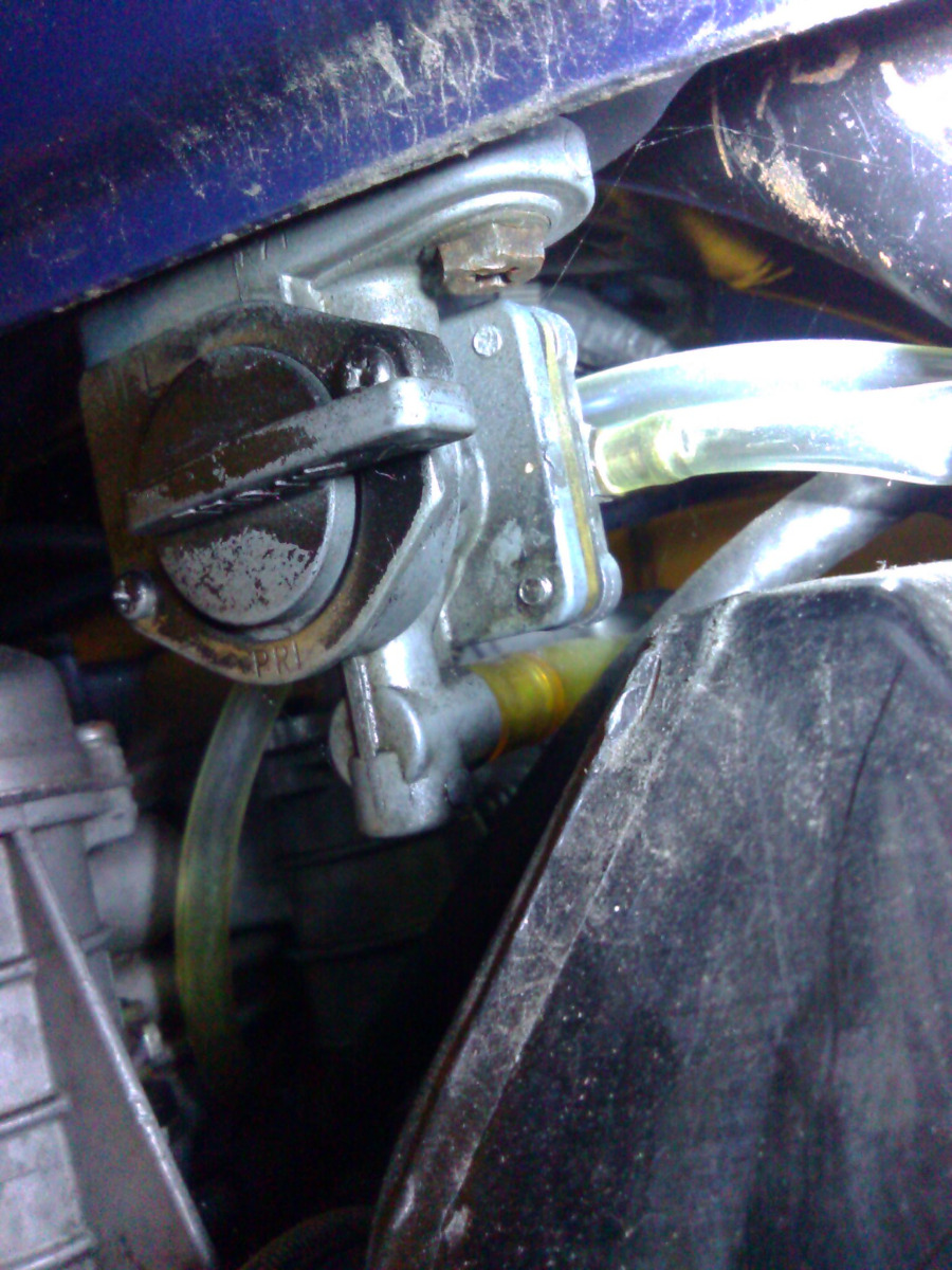

This is from my sons 78 kz650, it has the prime in the down position, the clear pipe coming out the side is the vacuum line
The black pipe is a breather and the clear is the other end of the vacuum line , there are 2 breather pipes and 1 fuel line and 1 vacuum line
