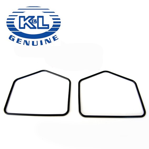

I was looking at picking up some fuel bowl seals, and came across some formed sets that looked like this:
Then I started thinking it might be worth while to pickup a more inclusive rebuild kit for a few bucks more, just to have some extra parts on hand (so far the carbs seem in pretty good shape after the first teardown but you never know, better to be prepared). Each time the bowl seals were offered as part of a kit, they were unformed, just round o rings:
I originally liked the formed gaskets since they matched the shape of my current sealing surface, however I am wondering if there is really much difference between the formed and unformed? Any real benefit to one over the other? Is it worth it to buy them separately to get the formed? Or am I just completely over thinking this lol At first I thought they might have even been the wrong gaskets since they didnt match my bowl shape, then a bit more reading lead me to this point here.

I use the round type, purchased in bulk from an O-ring store. A dot of adhesive, I use superglue, is required at each corner otherwise the O=ring wants to pop out of the groove in the float bowl.
