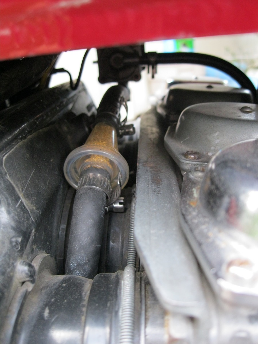

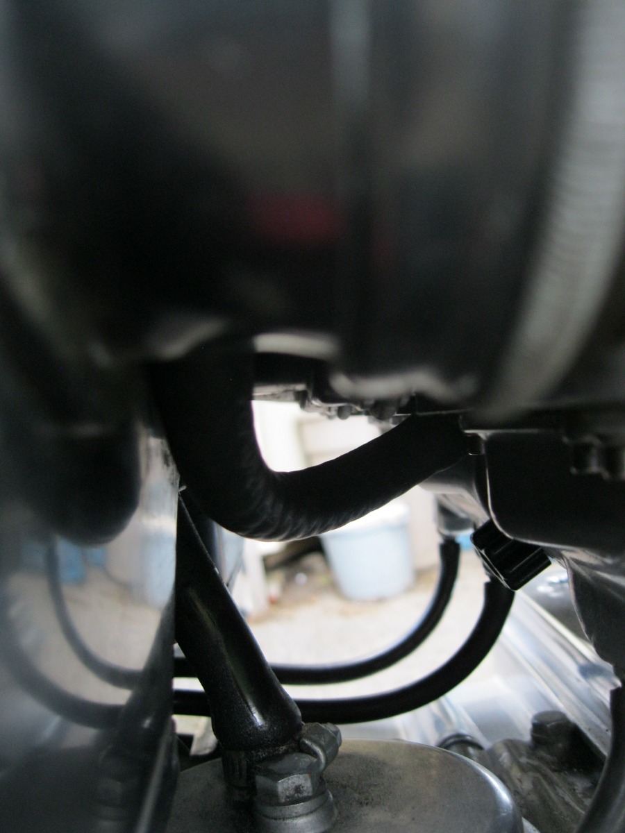

You are right. There's not a lot of space under the tank for fuel line and filter.
The photos below are taken from the right side of my bike and you can see the fuel line goes down between carbs 3 and 4. This gives me no sharp bends (kinks).
The second photo shows the line from below. All curves are gentle.
Is your fuel filter designed for a motorcycle ? Some non motorcycle ones need a fuel pump to work properly
When I had the pods and a Mac 4 into 1 exhaust the bike ran well with the jetting described in my earlier post. A jet kit should work also.
The main reason I got an airbox is because I was going for a more stock look. Best thing I did with the carbs was getting the service fuel level inthe float bowls in spec
