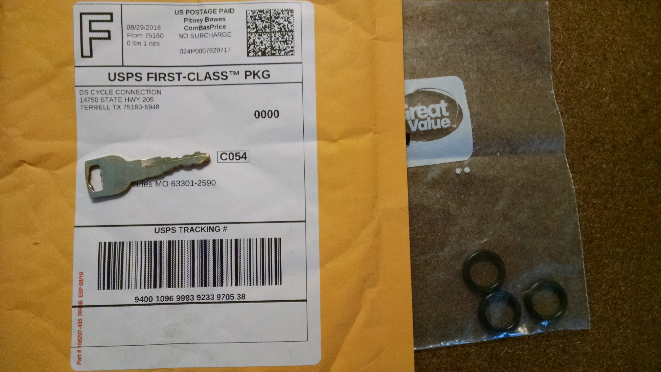

Jayrodoh already measured it and gave the part number too. You both probably posted at the same time and you did not see it. When I googled the part number it pops at 19.99 on eBay + $2.00 frt.. WTF? ANOTHER 50 cent part that we are getting gouged on. It looks to come in a package of 8, but this genius gouger is selling ONE for $19.99 . Much like the special o-rings that they are gouging customer on. Just like printing money, when it's almost 100% profit. I have lost mine before, but was fortunate to find them after totaly cleaning out my shed and sweeping the floor, then using a magnet to pick through the sweepings and thankfully found them all back.
He said they are 3 mmX7.8mm. You can cut down the length, but the diameter can't be changed. 3mm=.118". Just under the .125" diameter of the detent ball. The ball can be found at the mom-pop hardware stores. I could not locate the springs anywhere.
Just like printing money! lol These 3 o-rings cost me $15.85 shipped. A real bargain considering most vendors want ~10.00 each PLUS freight. Daveo spotted these for me last week for under 5 bucks each.
