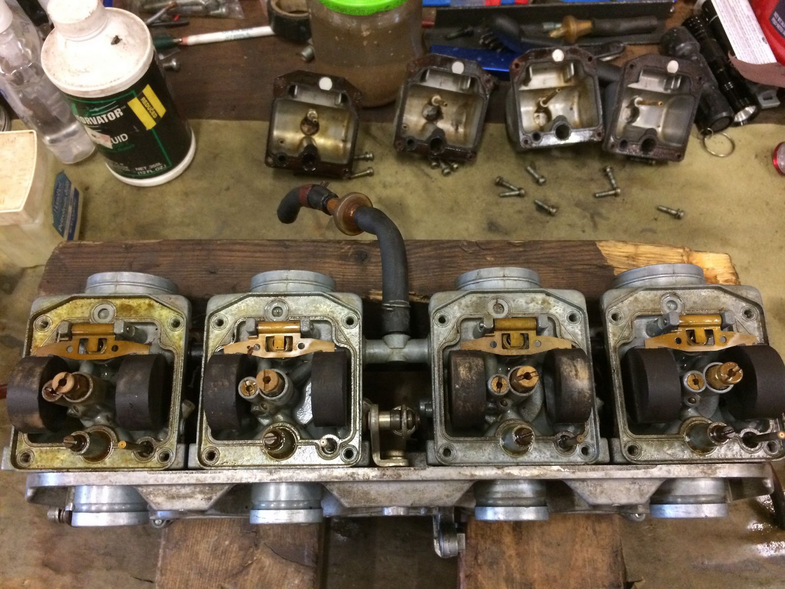

So i just got a 1977 kz 650 and i can start it when i spray gas in it and or starting fluid i cleaned the carb with a wire brush and cleaner i got it all put back together and on the bike and it still wont run on its own power plz help

How old is the battery, and is it fully charged? The 1977 KZ650 will not run if the battery is not good. Ed

Did you break down the carbs, removing all the jets, and soak everything in carb dip to make sure all the passages are open?

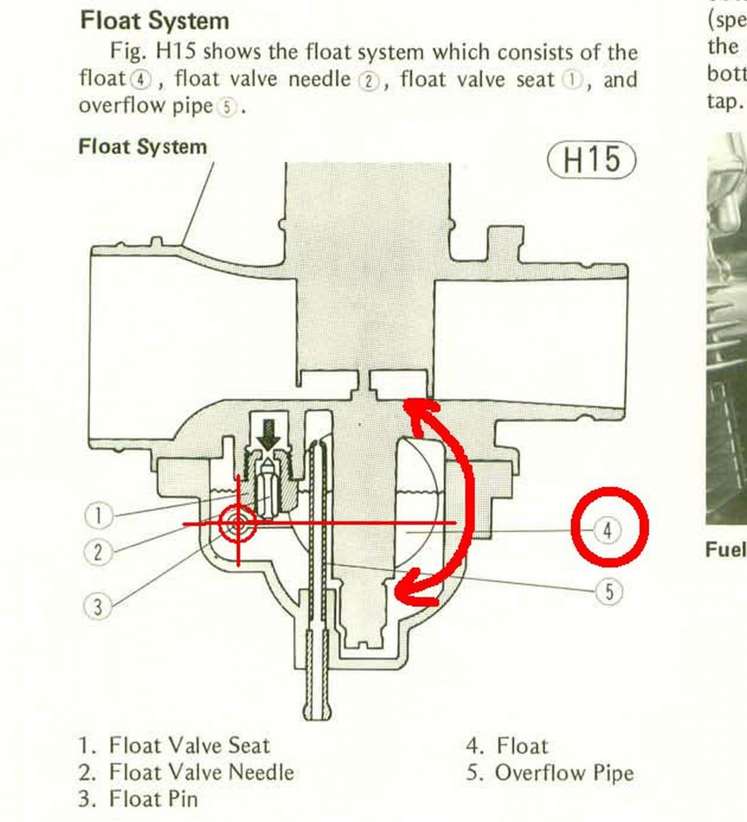

It looks like you have you have installed the float,( it regulate the fuel level in the bowl), upside down.
IF you never do a carb rebuild this could be possible. If you do so, your fuel level will be very low.
Open the carb bowls and check the right position of the float!!!!

Yes i can see through all the jets the carb is clear i sat for hrs last night cleaning them the bike will start when i spray gas into the bike

I do believe they are all correct in possitions the guy who had it took the carb off to clean them but he was scared of bikes so i got it in on a trade and i have cleaned the carb 2 times now and still no luck

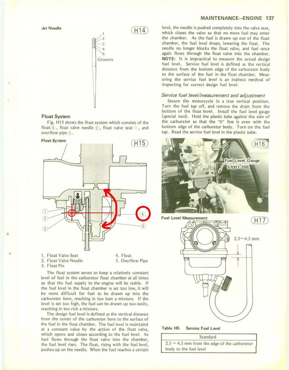

Remove the bowls and verify the correct position of the floats and fuel level in the bowls.
"I do believe they are all correct in positions" is no knowledge, you have to confirm.

Pilots? it appears to me the pilot jets are missing.

Pilot jets are there but they go down in the tube and where are the mixture screws

The screws you mentioned are fuel mix screws. Air mix screws are on the carb body side. Some vm 22's and 24's had just fuel screws , some had just air screws and some had both.
