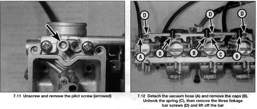

Does this thumb adjustment on the side of the bike (photo, right) terminate/connect to the pilot screw in the photo on the left?

04 May 2018 08:44jwtulane wrote: Does this thumb adjustment on the side of the bike (photo, right) terminate/connect to the pilot screw in the photo on the left?
No.
A pilot screw (aka mixture-screw or air-screw depending on the carb construction) adjusts the ratio of air to fuel when the bike is idling. Each carb will have its own pilot screw. Some rare carbs will have two on each carb. The pilot can be on top, on bottom, or on the side of the carb. If its on the side, but closer to the engine, that usually makes it a mixture screw where the screw affects the ratio by controlling the amount of fuel(mixed with a little air) supplementing the throttle opening's air. If its on the side closer to the airbox/air-cleaner, then its usually an air-screw where the screw controls the amount of incoming air into the pilot system.
Air screws might be a little trickier to set, but they tend to be less problematic in the long run, in terms of gumming up and cleaning, since they never get fuel on them.
An idle screw (aka idle-speed-screw or throttle-screw ) controls how much the throttle is open when the bike is at idle. It sets the minimum throttle opening position, which is when you let go of the throttle. This adjustment has one knob that affects all four carbs. The knob can be in the middle, above or below the rack, or on the side of the rack using a remote cable.
The two things are very different.
