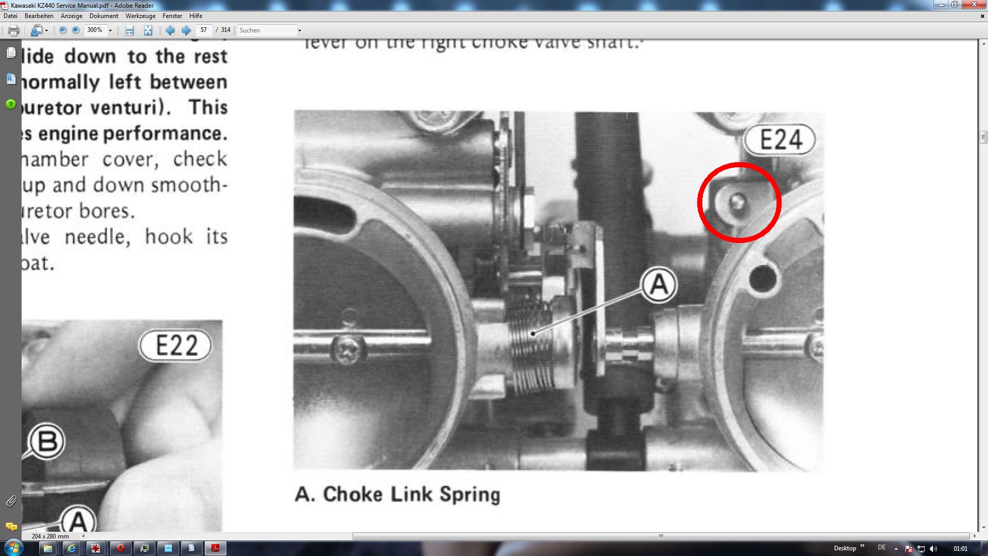

Hi, first time posting here. I came across an 82 kz440 it needed some work. Mainly the carburetor. The bike had been sitting out for a couple years. I successfully clean ed the carburetors and put it back together... It started! the bike bike ran great but as you can see in the picture there is a small knob where gas pours out when it's running or set to prime. I don't know if this is an overflow or what. I'm hoping and fairly sure it's a simple fix. any help would be appreciated I've looked through the forms trying to find information on it to no avail. Thanks again.

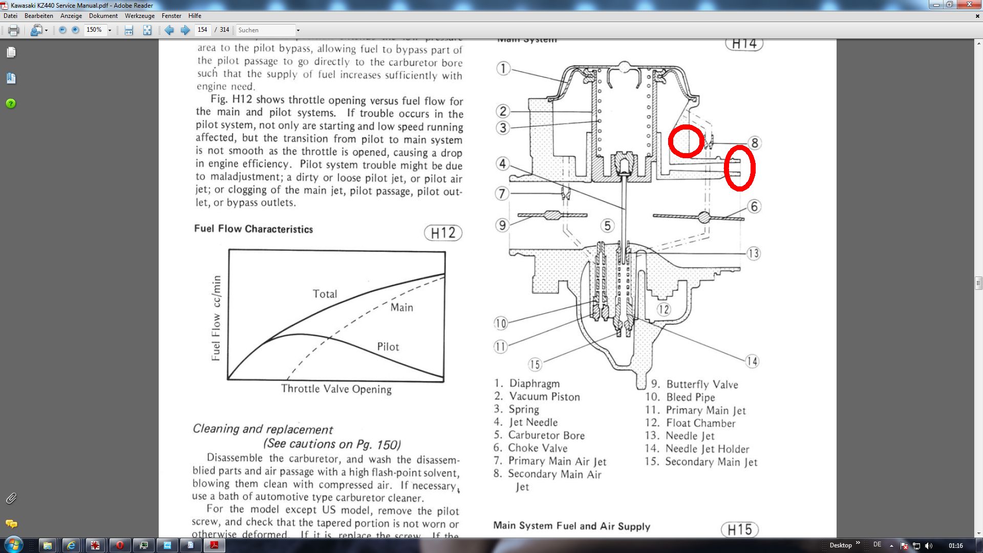

AFAIK, this is only a brass plug to close a vacuum port (Diaphragm???) and not an overflow drain plug.
There should be no fuel leaking out. Degrease the area and put some drops of Lock-tide or screw secure paint on.

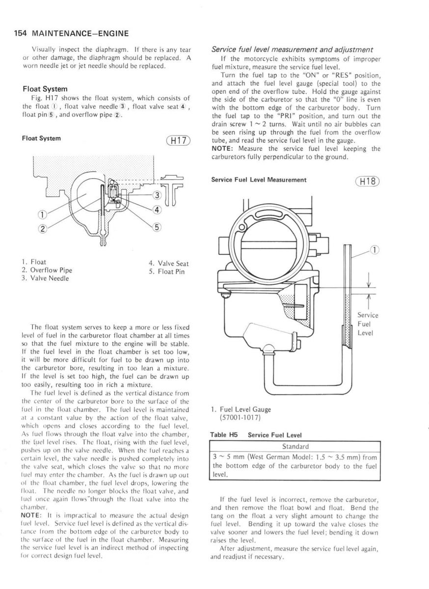

Check your float bowl high
