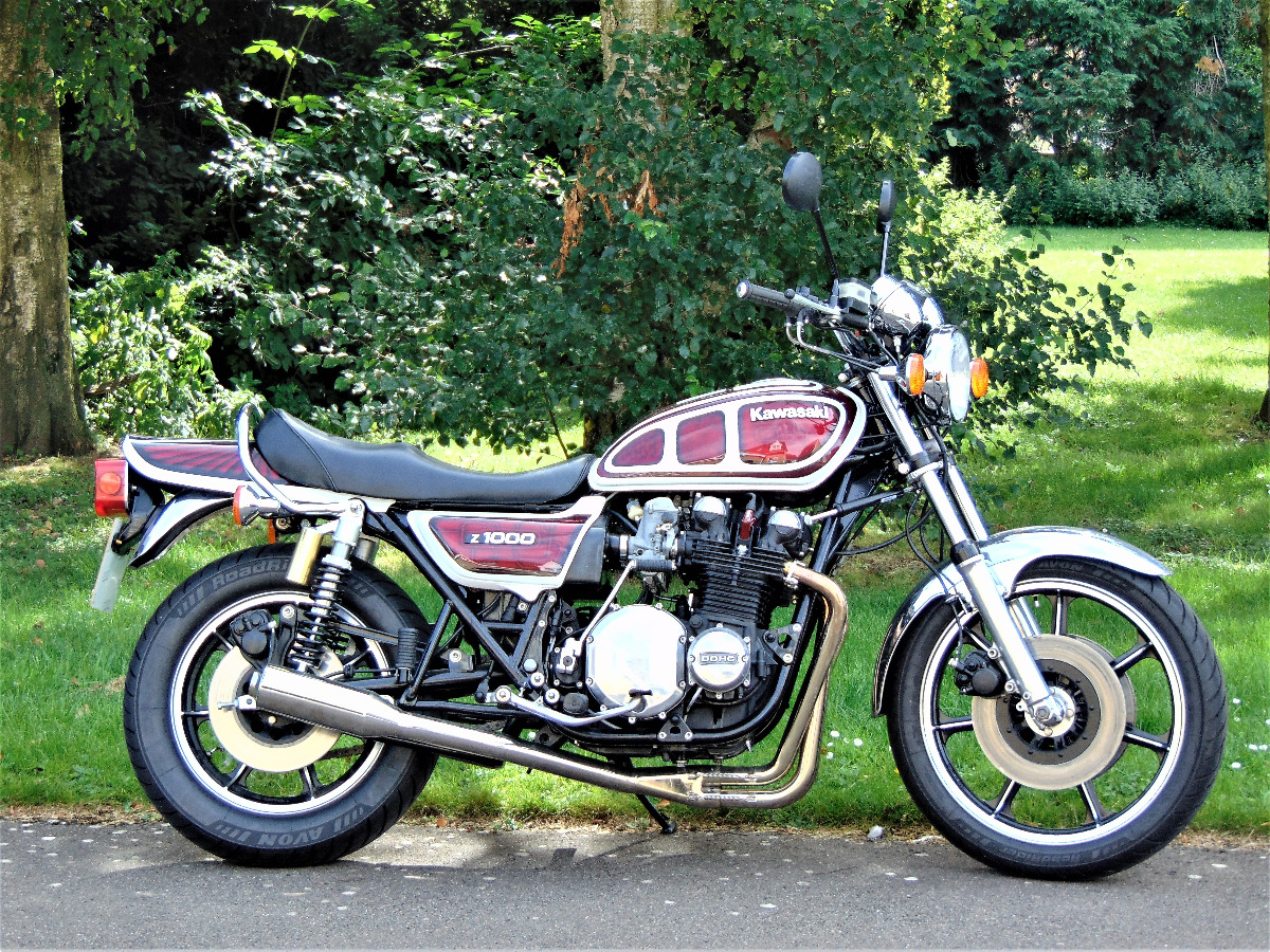

This is my B2, there are no smog attachments and a non standard exhaust i also have a stock air box, the jets had been played with but i now have a 107.5 main, a 20 pilot, needle 5cn7 on groove 3, pilot screws 1 & 1/4 turns out, runs perfectly, when i got it it had 117.5 main, 25 pilot, needle 5cn7 on groove 4, and it ran like a pig, if you aftermarket exhaust with some baffling, go to the same as mine you wont be far out 102.5 and 105 jets run too weak,.

Hello,
beautifull bike, congrats for the job done.
So clean ! would like to see inside
Is your exhaust 4 in 1 ?
Best
Fox
Best
Fox

Yes, stainless 4into1 with a harris road baffle.
