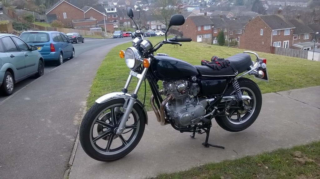

I had a 78 xs650 until recently, the problem you speak of is common to all bikes that use CV carbs mixed with pod filters it just does not work you can fiddle around with jets all day long and you will either get it right at lower or top end running another reason why performance bikes owners change to round slide and flat slide carbs, the very best thing you can do is to get stock air boxes or change carbs to non CV, with the aftermarket exhaust i ran a Delkevic two into one with all supplied baffling (still loud) and did not have to re-jet, but with some exhaust you may have to come up one or two sizes on each pilot and mains, There is always some sort of bun fight going on in the XS 650 sites about this subject and many fart around trying to get their bikes to run with pods and reckon they have it running perfect until you hear it and it runs like a pig. Stock airboxes is the way forward.
