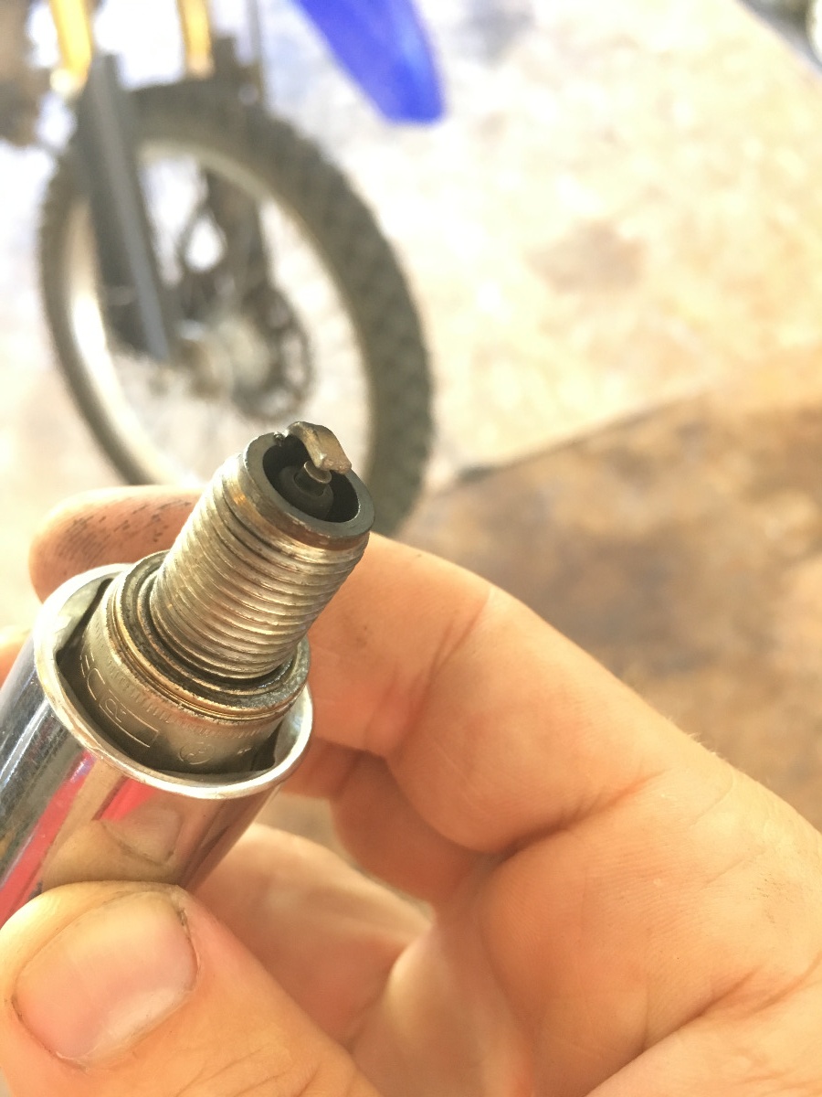

Major breakthrough!!!! Thank you Tyrell!
I torched both plugs to remove fouling, reinstalled, and lowered float height 2mm past mukini specs. Immediately thought I felt it running better, but drove it around and pulled plugs and for the first time ever they're not sooty! Don't smell like gas! Three short drives around neighborhood and plugs look like this: (even one short drive before would make it comepltely black
Float height!!! Good lord.
I guess now I'll start jetting all over again since now my plugs don't foul. Still have a power lag right when taking off from stop sign (will even choke out if cold) so from what I understand that's needle clip...
Thank you so much for giving me hope!
