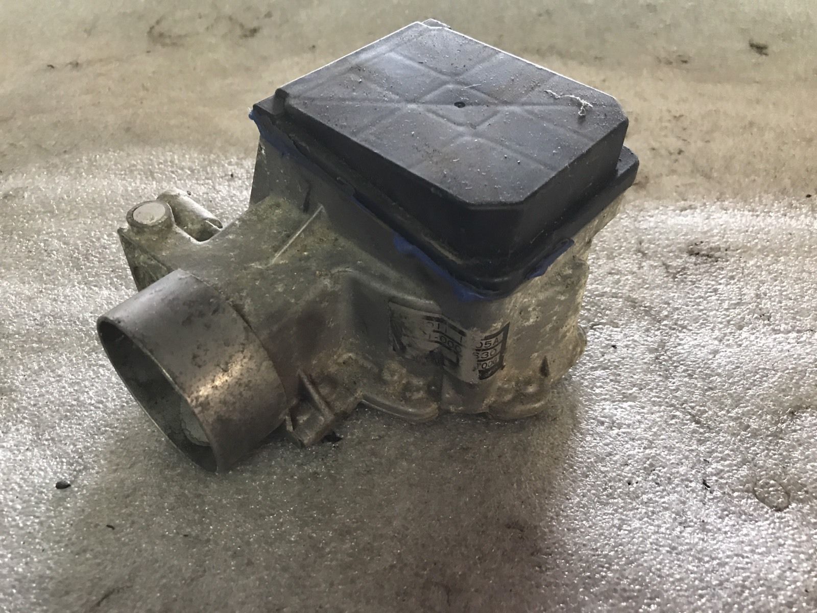

No eBay APP ID and/or Cert ID defined in Kunena configurationDOHC is right,the early EFI systems have a air flow meter and the injectors in the cylinder head
