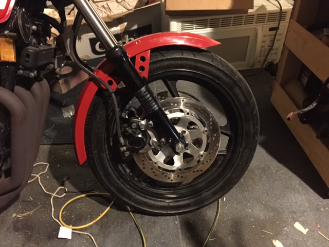

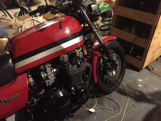

Believe my I know the feeling..I just now got my 81 GPZ1100 back on the road. I did the full carb conversion and wheel upgrade.
