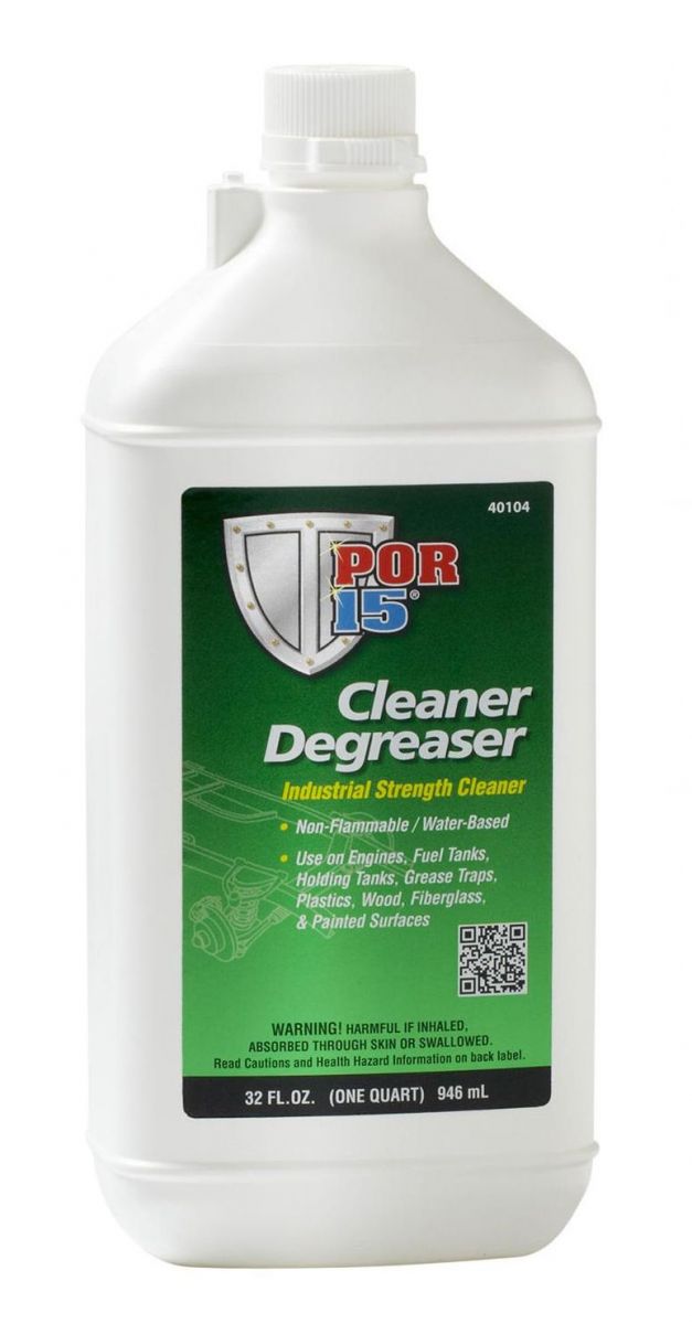

Re: '83 KZ550 - Surface Rust inside Gas Tank
18 May 2017 14:08
Before you go with rust remover you have to degrease your tank with POR15 Marine-Clean.
This sort of grease protect the rust under the thin grease surface in the tank and disabled a 100% rust remove by phosphoric acid.
18 May 2017 15:02 - 18 May 2017 15:08
Its time to do a rust removal before you get pin holes by the rust.
Get a POR15 gas tank sealer Kit for motorcycles
www.por15.com/POR-15-Motorcycle-Fuel-Tan...pair-Kit-_p_106.html
I used the same kit over 10 years ago on my project bike,
18 May 2017 15:45
That tank looks to have a combination of gasoline varnish and rust in it.
1st step is to remove the varnish. That Degreaser Cleaner stuff Scorocco linked works well. Carb dip works well too as would that Yamaha carb dip stuff.
2nd step is to derust. You can't do this properly until step 1 is complete.
