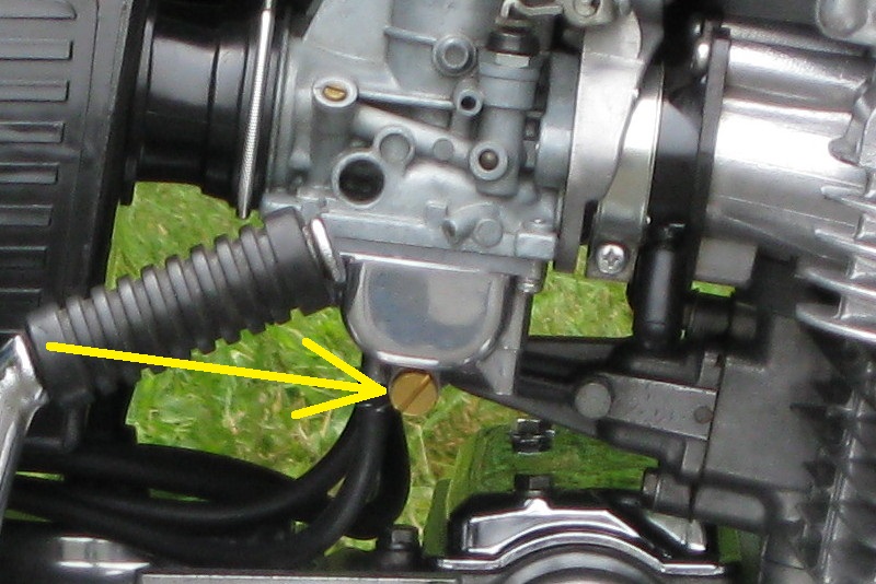

If you are referring to the screw shown below be sure to use a screwdriver with a large blade that fits the screw. That should give sufficient bite to loosen it. Ed

Ed, That is the screw that I'm talking about . And I'm using a Large Blade screwdriver that fits the slot well ? Unfortunately, nothing is working yet and I didn't want to use an impact driver in fear of breaking something. I really wanted to remove them and even replace with new and o-ring. but maybe I should leave well enough alone ? Then it would prevent me from setting the float levels with the clear tube method.
