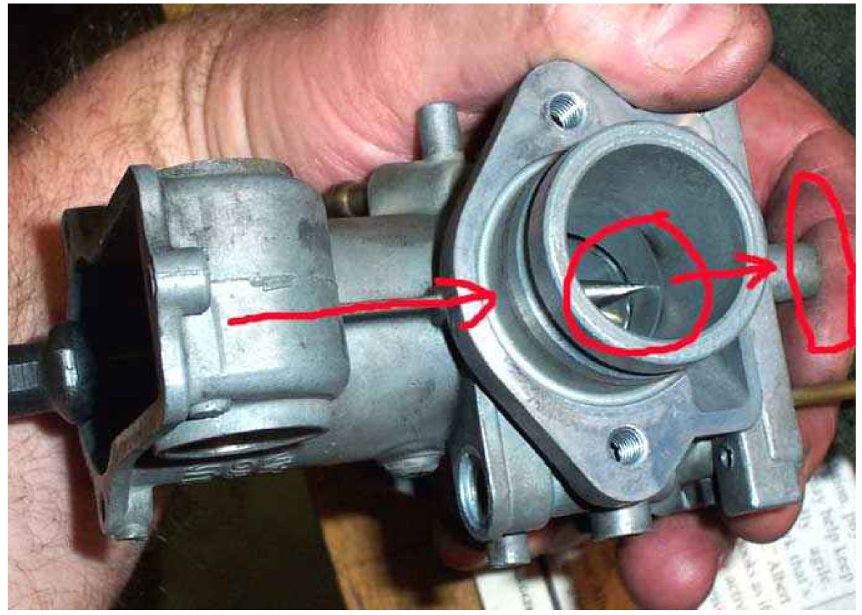

Before you waste your money try to remove the stuck pilot screw needles.

What Ed said is correct and is good advice, and you'll like the bigger carbs. But I also agree you may as well try to extract the broken needle tips. I would try to use something that's not going to score or damage the surrounding aluminum or the hole itself. My chemistry knowledge is sorely lacking in this regard, but maybe someone else on here knows: Is there a liquid chemical that will dissolve brass but leave aluminum unmolested (and wouldn't be illegal or unreasonably dangerous to possess and handle)? If so, maybe you could get some, drip it into the threaded needle hole (with the carbs upside down), and let it soak until the brass tip comes out - sort of like using an alum solution (or whatever it is) to dissolve a broken tap. If not, I'd try to push out the pieces with the tip of an aluminum nail/screw or a piece of hard plastic - turn it to a point using a hand drill and some sandpaper if you don't have a lathe. It looks like too tight of a fit, but maybe a pair of micro needle nose pliers, like for small electronics work, would be able to reach into the hole and grab the broken piece, or could be ground-down to do so?
While we're on the subject of carb needles: I've overhauled a variety of Mikuni and Keihin carbs - sometimes installing new manufacturer needles, sometimes needles from K&L rebuild kits - and in the process, I've noticed that the taper of the tip of the replacement needles varied widely from the taper on the tip of the original needles. What's more, I never found the performance was affected to any noticeable degree. Sure, the exact number of turns-in needed for a good idle mixture might have been different, but that was it. This makes me wonder: Could the hole for the needle tip suffer some small amount of concentric damage (swaging or the like) - such as if a steel tool were pressed into it to eject broken-off needle tips - and still work fine? Seems to me it's possible, and thus it's worth a try to get out those tips. If for no other reason than you could then sell the carbs to help finance the replacement set.

For prosperity sake! I managed to fix my carb issues by bench grinding down a tent post in order to fix the problem.

Mikuni liked to use paint on the threads of those pilot fuel screws which makes the screw hard to turn. Because of that it's impossible to tell when the screw is "lightly seated" thus a lot of guys turn in the screw too tight and bust off the tips. Pushing the tip backwards using an awl solves the issue though. It helps to custom grind the tip into a sharp point.
There is no reason to replace those carbs. You may notice that the hole is slightly larger when done though. Only thing that does is allow the pilot screw to poke out of the hole in the carb body a little further. No big deal.
