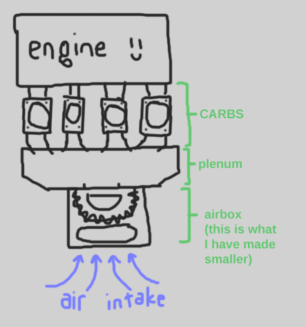

I've built a GPz550 into a little street fighter thing. When I cut the tail off and welded in the supports, I also ended up with a smaller area for an airbox.
To solve this, I made an airbox, based on the dimensions of the original.
I don't have a photo of it handy, but it uses the same inlet size, same filter and fits with the intake plenum perfectly.
However, the bike doesn't run right. Does changing the volume of an air box fuck with it's ability to work properly?
If so, do I need to rejet the bike? I also modified the exhaust. I've never done anything with rejetting a bike, would I just buy the dynojet kit?

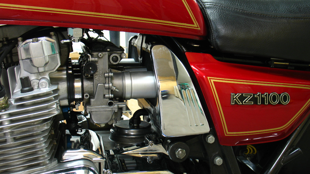

You posted a plenum with velocity stacks? That's pretty sweet.
