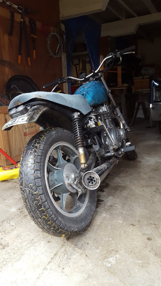

I have a 1979 kz 400 ltd,
I bought the bike from dead and I have been working on it for about 6 months now picking away and have almost got it going.
I can ride it or keep it going for about 10 minutes and when I slow down or let off the throttle it sputters and dies and its really hard to get going again. Ive restored the gas tank so no rust in the fuel, ive put on new intake boots, cleaned the carbs and put on a new coil, points and condenser seem fine. They are clean and have volt metered them to make sure .
Im really stuck right now and dont know what to do next.
