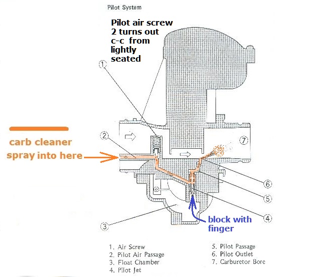

Could also remove the #1 pilot air screw, block #2 air inlet and #4 pilot jet, then spray into the now open #1 hole, and watch for spray to exit into the carb bore.
The idea is to assure a clean and clear pilot circuit.
Here's an illustration showing this and what to be looking for:
Alternative - - -
Could leave #1 pilot air screw in position (say 2 turns counter-clockwise from lightly seated) block #4 pilot jet, then spray into #2, and watch for spray to exit into the carb bore.
Here's an illustration showing this alternative and what to be looking for:
Alternative - - -

Thanks,Patton.I think I got it clear.Problem blocking multiple ports at once is that I could only get a pinkie in at #4 without pulling the floats.I blocked what I could and sprayed into different ports and cleaner was flowing well to all openings.Gonna open the bowl and do it again before I put the carbs back on just to be sure.
