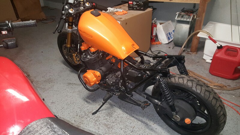

Thanks so much for the info kx100 carbs are way cheaper on ebay I can get a set for 100.00 while the ltd ones people are asking 300.00 which is crazy... I'm also a little worried about the front end ... I'm not sure if you. Can tell in the pic but there is not much space between the 4in 1 and the floor and the forks are maxed out

18 Sep 2016 21:00dano582 wrote: Thanks so much for the info kx100 carbs are way cheaper on ebay I can get a set for 100.00 while the ltd ones people are asking 300.00 which is crazy... I'm also a little worried about the front end ... I'm not sure if you. Can tell in the pic but there is not much space between the 4in 1 and the floor and the forks are maxed out
Careful on buying these BS34 Mikuni's used - try to get a set from a bike that ran PROPERLY and RECENTLY, and not a set that has sat on a shelf for whatever reason for the past 5 years - otherwise you might be buying a whole bunch of headache for that $100!
I would gladly pay $300 for a good set without major issues, compared to $100 for a set that won't get your bike out of your driveway....
