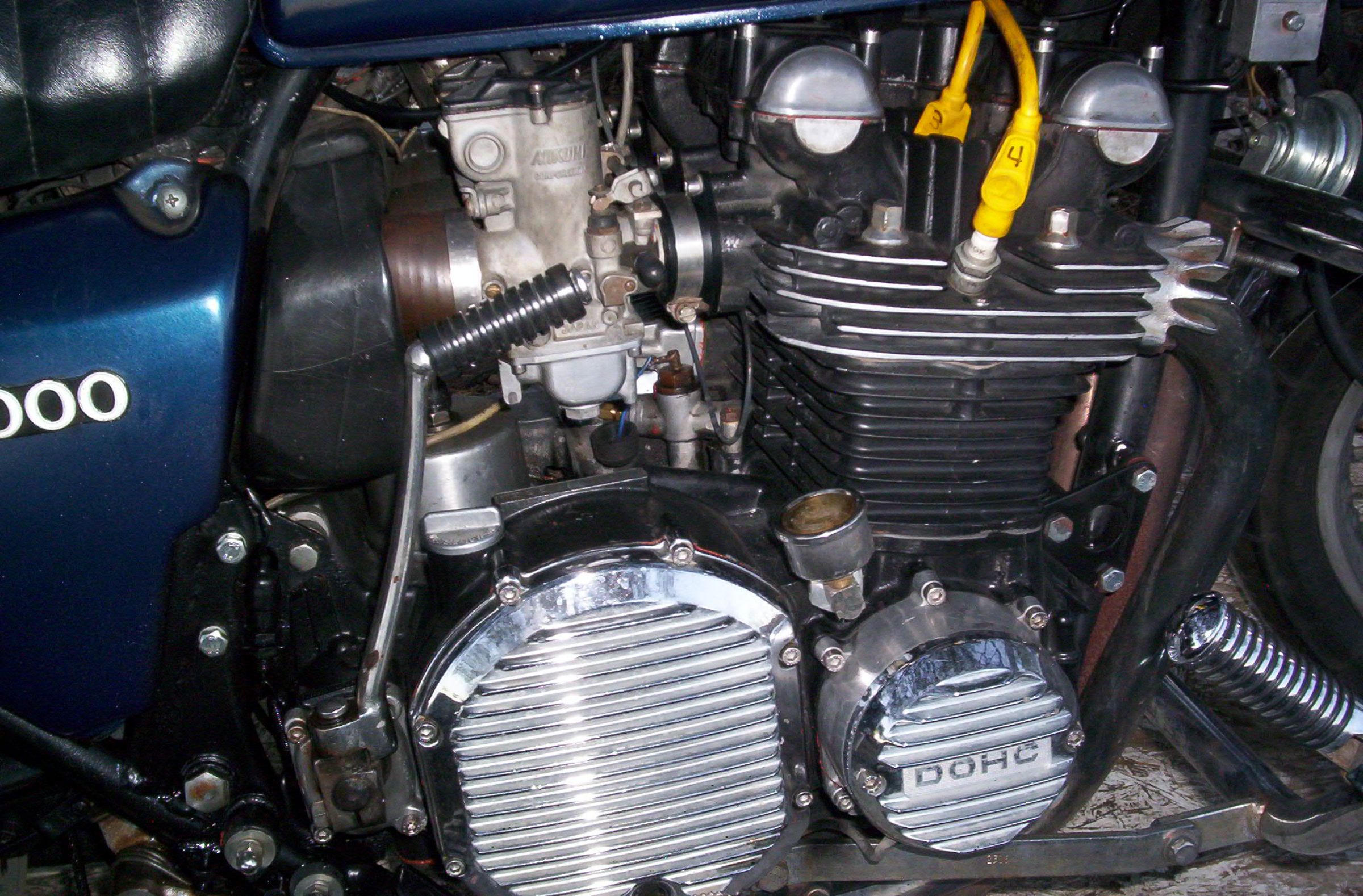

I might end up going that route and getting some new mikunis if I cant get them to run properly. I also heard that somehow restricting the pod air flow with tape and such could help. Also Steve how did you make those boots?
- Posts: 23602
- Thanks: 2980
Re: New to forum! need stock airbox for kz400
16 Aug 2016 18:06
Silicon hose. If the ID to the carb is right, the OD of the boot will fit snugly in the box. Cut a little longer so you have a velocity stack effect inside the box. Mine don't look like that now. The insides still do but the outsides don't. Next time I'll use radiator hose like I did 17 years ago.

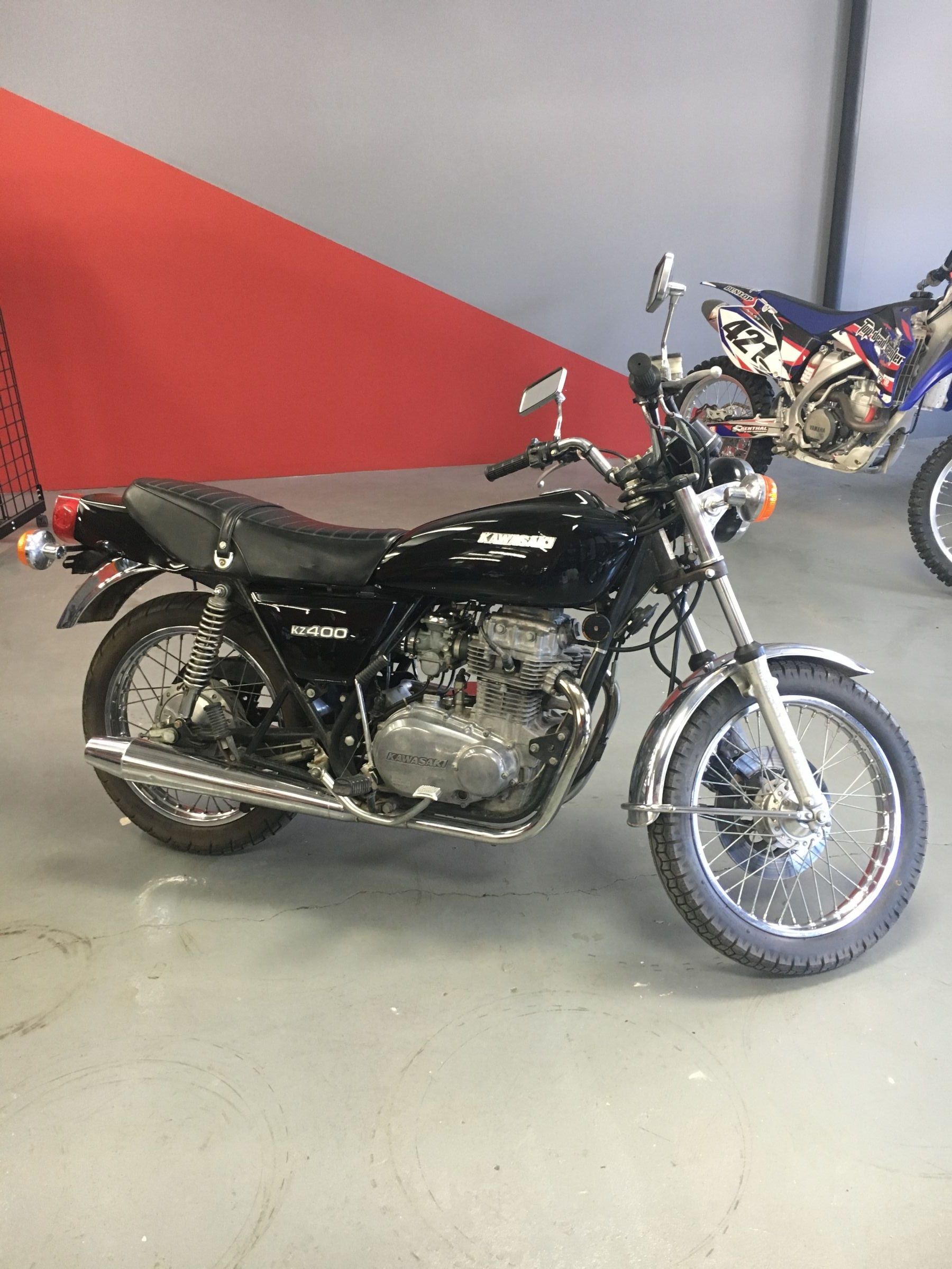

Pics of the bike?
- Upstateofmind
- Posts: 8
16 Aug 2016 18:21
Five minutes before I bought her
