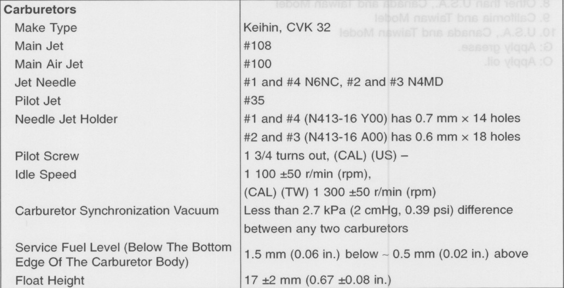

Ah...TPS means they are from a zr-7.
Which is good as the zr-7 is identical to the '82 gpz750 mechanically and performance wise.
So the stock settings are as follows.

Ahhh well the 110's are closer then and with a 4-1 header (mac mega yosh header) I may even be lean when I get out on the road.
Still it's failing on the idle circuit so must need to look closer at the pilots and maybe give the needles a look the see if someone has botched things.

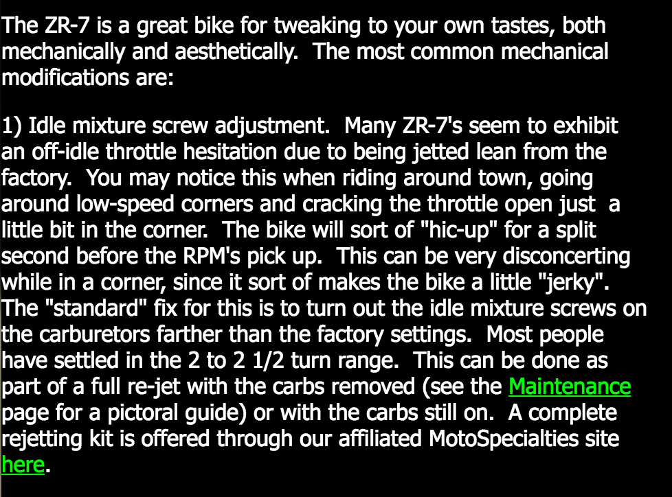

The more I thought about it...1 3/4 turns is very lean setting. And I remembered reading about the zr-7 "low speed stumble" and wondered if this was partially due to the factory idle speed setting and this is what I found.
Richening the idle mixture by turning out the screw may help.
But as you mentioned, I would recheck to make sure the previous owner didn't accidentally mix up the needles or the emulsion tubes as they are both different between the 1&4 and 2&3 cylinders.
