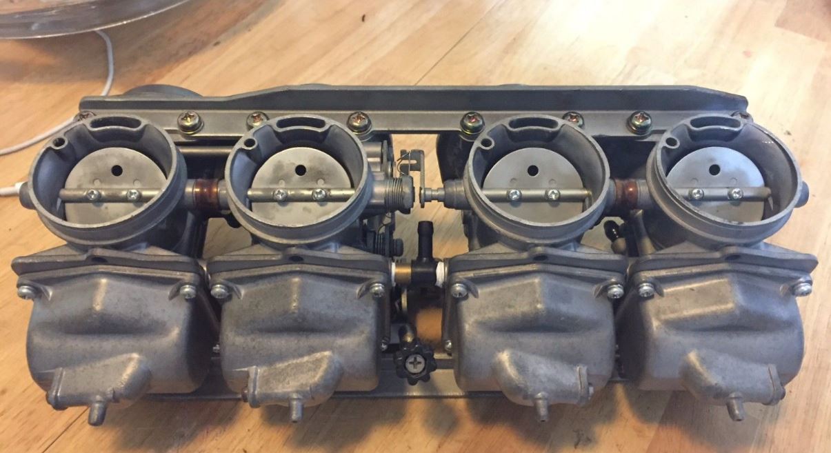

19 Aug 2016 15:38 - 19 Aug 2016 15:42
No eBay APP ID and/or Cert ID defined in Kunena configurationIf anyone wants to see the quality of work that Wired George does check these out...
He bead blasted the steel parts to remove corrosion but he doesn't replate them so they rust. The butterfly valves and all the choke linkages are supposed to be zinc with yellow chromate. These parts will start to rust very quickly when the carbs are put into service.
Also, he uses teflon tape on the fuel Tee fitting. All can be had for the fee of $400. :sick:
