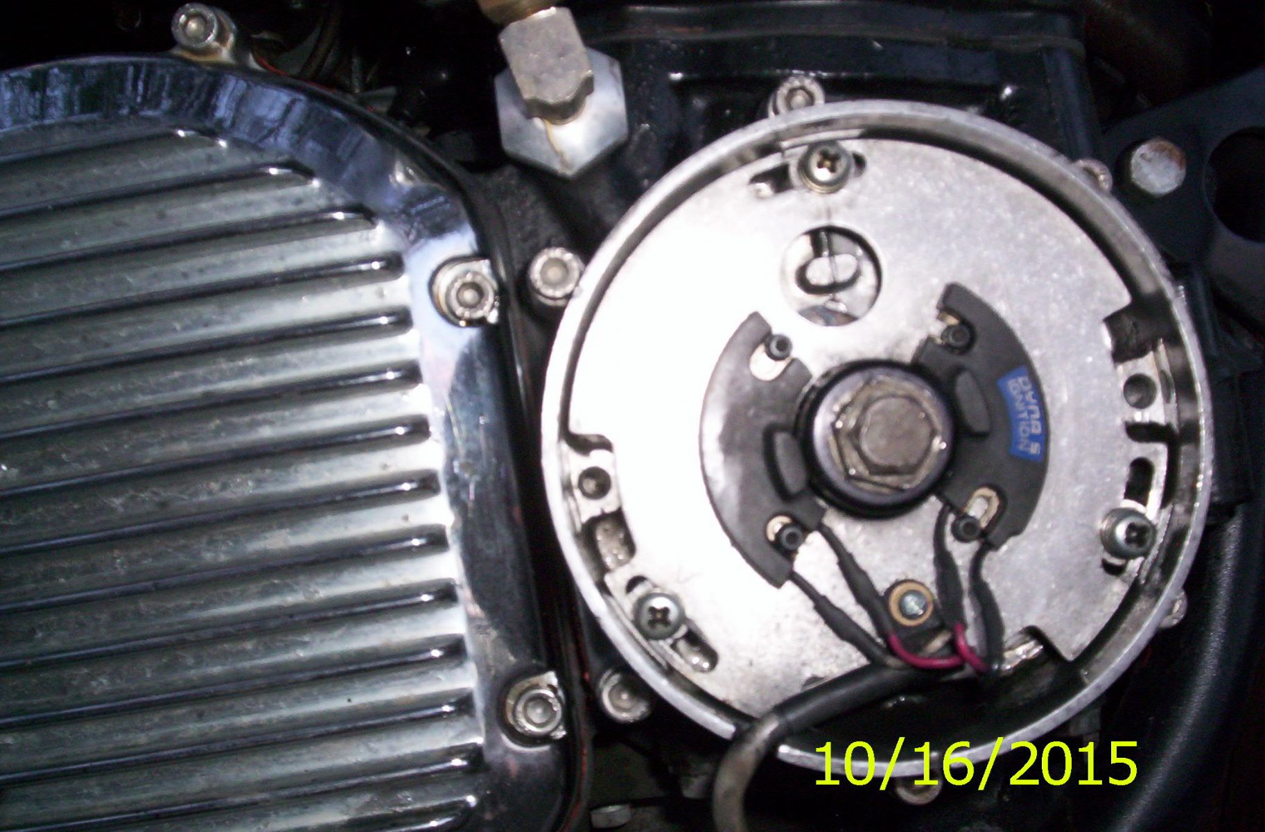

So I took the tank off and checked the cables they looked ok.I lubed them up and tried adjusting them as per the manual.It says to loosen both cables at the upper adjusts at the grip.Then it says to adjust the decelerator cable til there is no clearance between the cable bracket and the stopper,there was about 1/8" clearance when I began.Well,no matter how I adjusted the cable I could not get the clearance out,or make the clearance wider.After an hour adjusting both ends of the cable with no luck,I realized the clearance was being caused by the idle adj screw.There was no mention of the idle adj in the instructions at all.So I adjusted both cables as best I could and took it for a ride.It functioned better today,no sticking on decel,but it does come down a little slow when I rev it in neutral.It idles a bit rough and probably needs a full tune up,as suggested earlier by Baldy 110.I assume this bike still has the old points,who makes an electronic ignition to replace the points?

The points ignition works quite well when properly cared for. Points and condensers are much cheaper than a whole new system. If you are going to replace, be sure to replace those old coils, too.

Thanks for the replies,guys.I'll probably stick with the points,cond for now.The bikes gonna need a complete tune-up,carbs synced,valves shimmed etc.I 'm gonna let a mechanic do it all this time,I want to ride this bike NOW,dont wanna spend a lot of time getting it in shape.I'll look into the elect.ign later.The brakes are good,but that I can do easily,I can hear the timing chain rattling some,thats an easy adj. but I'll have the wrench do that while he's tuning it up.
