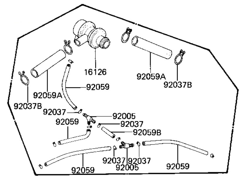

07 Jul 2016 20:26
Would be similar to the following clean air system on a KZ750 twin.
Many of the stock clean air systems on various Kawasaki models have already been permanently removed.
If the bike at hand came stock with a clean air system -- I don't know whether it did or not without looking it up -- it may have already been removed.
Where the stock clean air system remains fitted, its several hoses and connections are a fertile source for air leaks.
