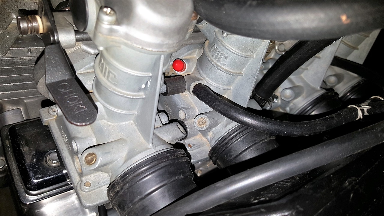

So here's the carbs in question, in situ:
Do I have my vacuum lines connected properly?

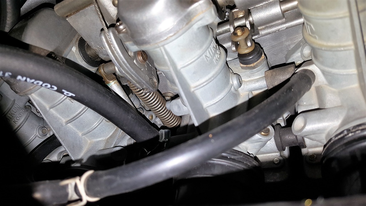

Pic one above, RED cap on carb 2, is plugging one port which I thought was connected to the emissions reed valve setup. Black hose below it routes to a "T" connector which is connected to carb 4 seen in Picture two. From the T connector the vacuum line is routed to the petcock although the hose is currently plugged without the tank on at the moment.
I connected the fuel line (seen in the second picture) to a bottle of fuel for test run. When I filled the bottle, every carb gushed gasoline out of the over-flow tubes and down to the garage floor at the center stand (ie: the over flow tubes are all routed to behind the engine, between the center stand and swing arm.

The red cap is vacuum. The T's are vents.

So the red cap should be routed by itself to the petcock and the ports on carb 2 and 4 should be blocked? Ack

The red one goes to the petcock. The vents go above the air box. The ports on the carb holders control the emissions or capped off.

First thing you need to do is differentiate the vent tubes from the vacuum tube. I'm not an expert on those particular carbs but it looks like the red cap is over your vacuum port line. Are there any other vacuum ports on those carbs? If not, you need to T that line and run one end to the petcock and the other to your reed valve setup.
The other lines that you seem to have joined together in a T look like vents. Those should not be plugged into your petcock since there will be no vacuum signal. I think these vents should be open to the air or maybe connected to your airbox. Not sure.

They are routed up to the air box so critters won't get in. They MUST be open to the atmosphere.

In the original configuration this bike had the emissions setup with the big tube from air box to reed valves etc but that was all hanging off the side, disconnected and the reed valves had been taken so basically all that jumble of vacuum was unknown to me, I was just going on a few forum descriptions, exploded views and assumption.
So the two vent ports (carb 2 and 4) should route to the air box. The only place to connect that tube on the air box would be at the bottom center of the air filter, there's a nipple but I thought that was a drain. I plugged the big hole from the emissions tube already.
Do you think this would prevent the carbs from working (the plugged vent tube)?

They don't connect to anything. Just open. I suspect with the blocked off the carbs might be flooding due to the siphon effect.

The vents need to be open otherwise the floatbowl's won't be able to fill properly.
