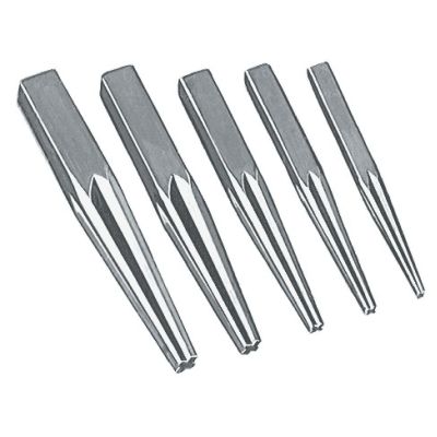

I believe you need this kind of screw extractor, not the spiral tip type...
I don't understand why the extractor is all blue. You should be using a torch or heat gun on the base of the post sticking up and then shoot the extractor down into the hole after it's heated. I used a full size torch on my pilot jets after shooting a bunch of PB Blaster down the hole first. About 10 seconds of heat was plenty to break all the old varnish and corrosion down.
