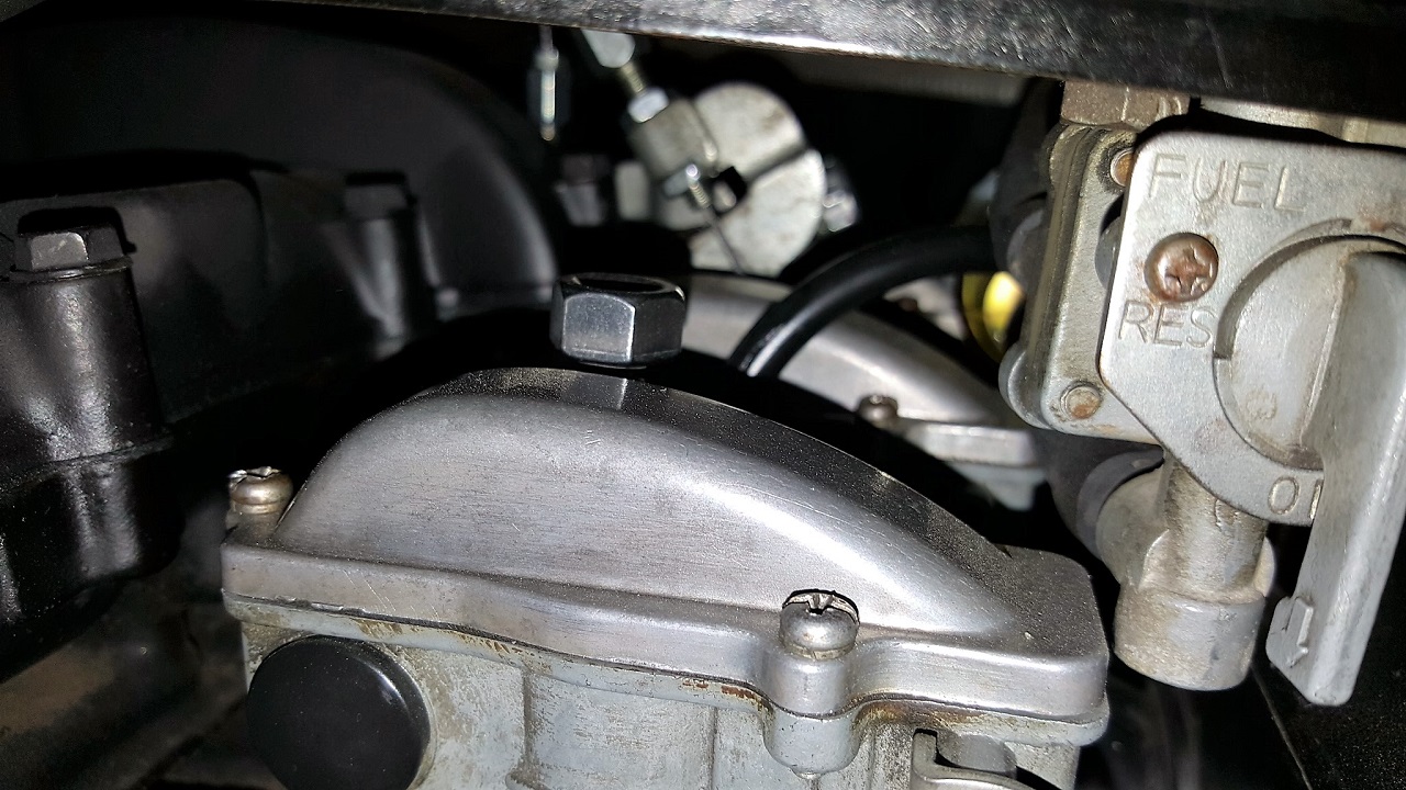

The throttle adjustment screw for the choke. Is that the Phillips screw in the bracket on the shaft that runs between the carbs? Anyone have a pic just so I'm sure?

I just took a pic of mine but can't seem to upload it from my phone. Ill upload it from pc here in a few minutes.
But yes, there is a screw between carb 1 & 2. Sticking straight up along front edge.
OK. Here's a pic of the screw in question. Mine has a 13mm nut on the top so it can be adjusted by hand while riding (well, pulled over but while out on the road). I don't think this nut is stock but was added by the PO.
Hope that helps!
Hope that helps!
