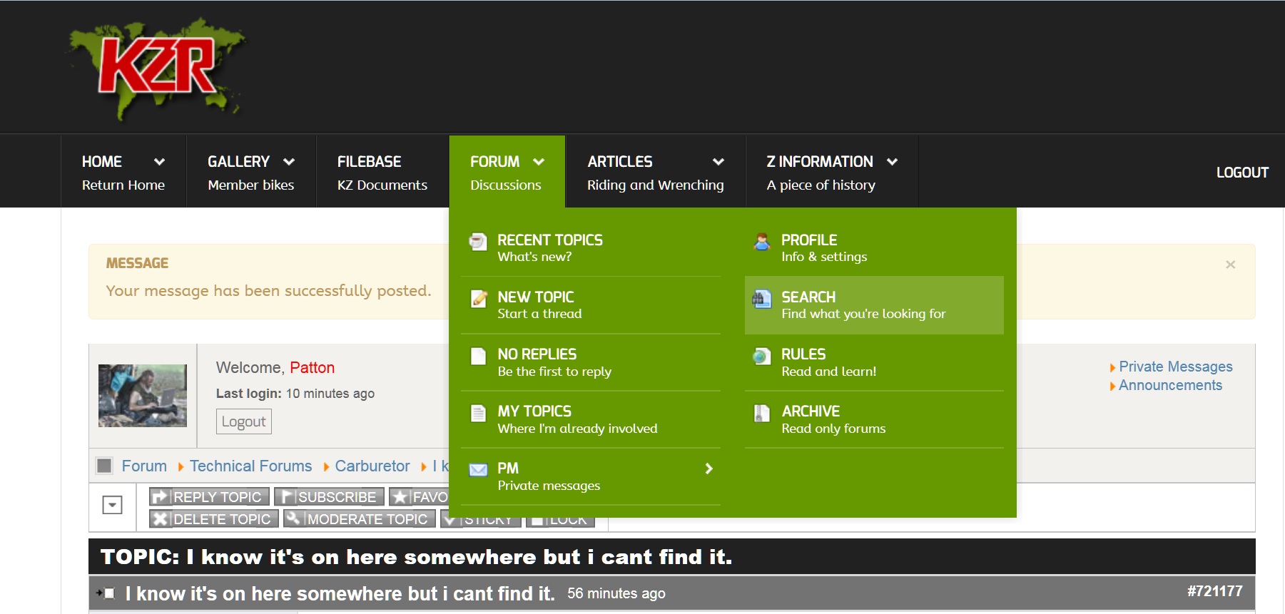

The SEARCH function is your friend. :cheer:
Good Fortune! :)
