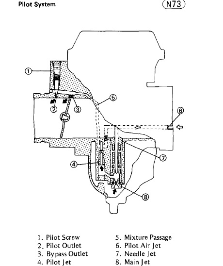

Here is my thought. Idle is fine, colortuned just inside to Bunsen blue. 1/4 throttle and up it pulls very hard. From my research, it looks like the pilot jet feeds the idle hole at idle but as you open the throttle, you uncover the two transition holes which are also fed by the pilot jet BUT not affected by the mixture screw since they are fed before that. Once you get past 1/4 throttle, the pilot circuit is out of play at that point. Since my issue is at that 1/8 throttle point, I'm thinking the pilot jets need to be bigger (or cleaned better). If I'm careful, I can usually get the stumble to go away by putting the choke on a little while riding (although I prefer not riding with my left arm under my leg). I've also noticed that the mixture screws are out 4.5 - 5.5 turns to go rich on the colortune. I did not record what jets are in there unfortunately.
Sounds like you have been really thorough but pilot problems can take several attempts.I think your reasoning is very sound. I have had exactly the same problem and know it can be extremely frustrating
If the carbs are Keihin CV34 then I would suggest first going back to the pilot circuit and removing the pilot jets. Clean each with a nylon bristle or guitar string. If you hold up a pilot jet vertically your may see a hole at the fat end but to the side. I'm not sure if this is to allow fuel from the main jet bleed or to allow one to hook out the jet with a bent pin or pick but I always make sure it is clear. You should also be able to access the main jet bleed pipe and poke
Regarding the transition holes (at #3 in the diagram below) you mention 2 holes. There are 3 in mine and I have had to poke each with a bent pin or wire to make sure all were clear.
Only the combination of carb clean spray, thorough poking with wire or bristle or 50lb nylon fishing all followed by through blowing with the compressed airline at thelocal gas station solved my problem.
Other than that I would suggest looking at the fuel float bowl service level using the clear tube method and checking the fit of the pilot plugs.
Check for holes in diaphragms - long shot
4.5 -5.5 turns out on the mix screws seems huge. I think mine are somewhere in the region of 2 - 3
If your carbs are Mikuni BS34s then best disregard the above
Good Luck

JR wrote: Regarding the transition holes (at #3 in the diagram below) you mention 2. There are 3 in mine and I have had to poke each with a bent pin or wire to make sure all were clear.
You are correct, three not two.
Sounds like I need to go back through them once again. I feel good about previsous cleaning (Pattons method, compressed air, etc etc.) but maybe something is just missed. The carbs were full of water when I got the bike and everything brass was green.
