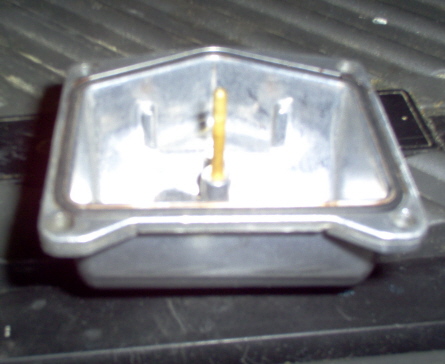

I see what you mean. Your picture of the float bowl looks exactly like mine which is the same as in the diagram 650ed posted (KZ250 CSR) and yet if I enlarge the picture of your bike the carb does look like a totally different animal
Heres a pic of my float bowl.
I hope I am not causing greater confusion.

That does appear to be an in-between carb. The earlier ones used a wire rod to hold the float bowl on, and the later ones were CV.
But the styling definitely looks older. Maybe Kawasaki was using up some older inventory body parts etc.
